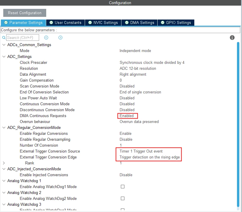

November 28, 2023
> When DMA1 is initialized, if the half transfer interrupt is turned on and the  transfer complete interrupt is turned off, the full transfer interrupt can still be triggered
How are you seeing this behavior exactly? Are you using your own IRQ handler or HAL's? Showing code would be informative.
Likely to be a software program bug, not a silicon hardware issue.

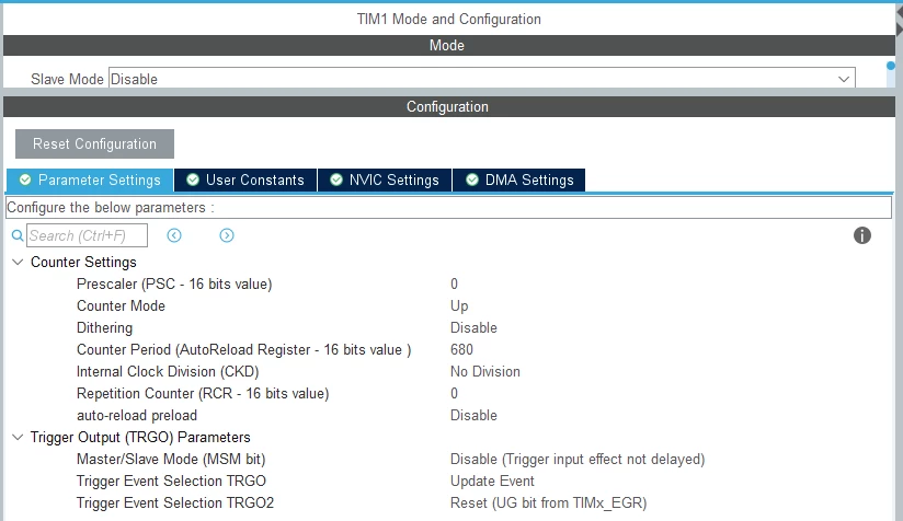

November 29, 2023
Yes,you are right.I used a timer to trigger the ADC.And in IRQ,check for HT being enabled & being set  has been resolved this bug.
