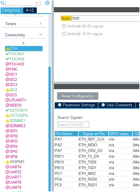

Why did ST assign a pin to their official board and software when it can't even be configured in CubeMX?
Looking at the Ethernet PHY circuit of the STM32H735G-DK, the MCU and MAC are connected via the RMII interface, and a pin named "RMII_RX_ER" is connected to the MCU.
However, if you configure it for RMII in CubeMX (version 6.18.1), this pin does not activate normally. If the user manually activates it with the mouse, the pin is marked in yellow, meaning the function is not properly enabled
Therefore, I checked the official Demo FW located in STM32Cube\Repository\STM32Cube_FW_H7_V1.13.0\Projects\STM32H735G-DK\Applications\LwIP\LwIP_TCP_Echo_Server\STM32CubeIDE, and even there, the pin is configured as GPIO_AF11_ETH.
I am curious why it was designed and developed this way when it only gets configured but doesn't actually function. Is it just missing from the ETH group in the CubeMX DB? Or is it originally an unsupported feature, but ended up like this because an existing circuit design was just recycled?

Now I’d like to add that I am not ST nor Synopsys insider and from the available documentation it’s not clear, if asserting ETH_MII_RX_ER signal at PB10, while the ETH MAC is configured in RMII mode, does or does not set the RE bit within the status bits of writeback Rx descriptor (in RDES0 in the original in ‘F4, in RDES3 in the newer one in ‘H7). It quite well may, and that can be established experimentally (although probably not at this board, as there’s no jumper at that signal to disconnect it and connect to a source of “manually” driven “disturbance”); now even if it does, whether it’s useful or not, is up to you to judge.

It looks like a mismatch between the board design, CubeMX database, and the generated configuration. Since the official firmware still configures RMII_RX_ER as GPIO_AF11_ETH, I’d suspect the CubeMX pin definition or ETH peripheral metadata is incomplete rather than the board connection being accidental.

More detail:
In CubeMX start a project from a board; select STM32H735G-DK, go to ETH config.
Checkbox “Activate Rx Err signal” is greyed out, with message: “Active only with an MII mode”, and the PB10 (RX_ER) pin is not included in the configuration at all.
If the RX_ER indeed can be used in RMII mode, this looks like a bug.
The example projects for this board have been created manually, without the Cube and .ioc file.
