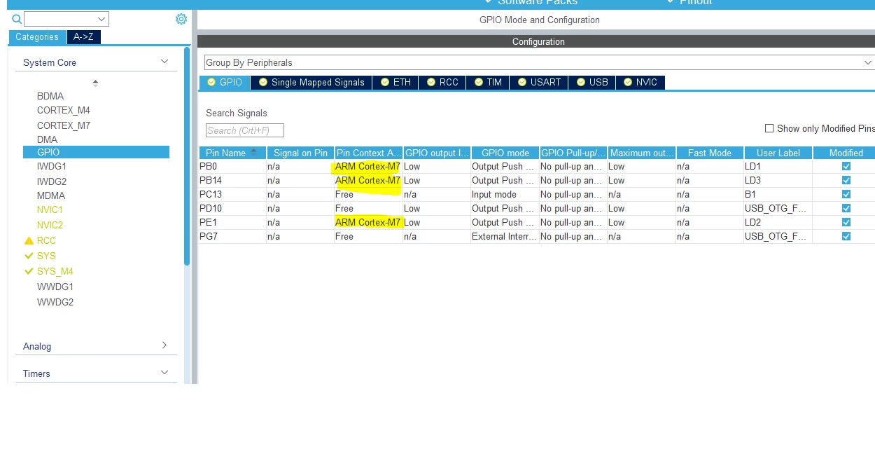

0693W000004HL15QAG.pngI was struggled with this for a long time. Then I figured out that we have to set the context for these GPIO(s) as shown below. CubeMX should generate them as expected.

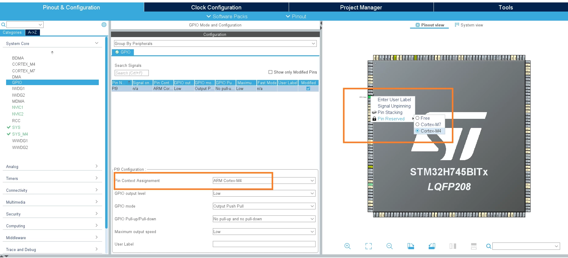

Hello @APism.1444​ ,
You need to reserve a context first , right click on pin and you will get a Pin Reserved option , or you can assigne it Under GPIO config /Pin context assignement .
