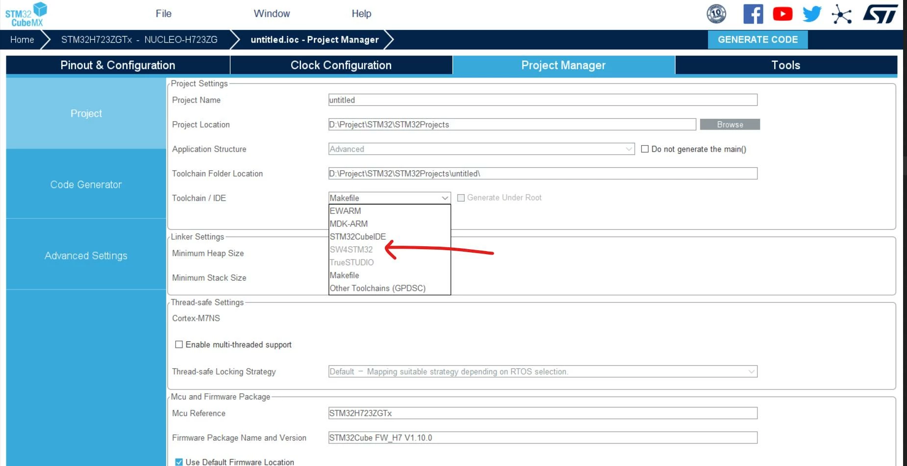

Why can't i chose the sw4stm32 as the toolchain when using cubemx to generate code? I'm using STM32H723ZGT. Thank you for your kindness.

SW4STM32
NRND  <<<<<<<<<<<<<<<<Why yes ?

As @MM..1​ says - Presumably because, like TrueSTUDIO, it's no longer supported?

Since SW4STM32 itself is no longer supported, it's not being supported as a code generation option on newer chips within STM32CubeMX.
