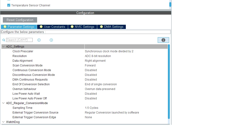

Why can't a blank CubeMX project not enter while(1) loop.
Hi
I used a NucleoF072RB and Cube MX. I use Atollic TrueStudio.
I wanted to know how to setup and AND before integrating it in another project. So I created a new blank project.
I set tup the porject as per the picture ADC_setup. No pin were activated on the MCU (except the default settings).
I generate my code. It compiles.
I test one line of code:
 /* Infinite loop */
 /* USER CODE BEGIN WHILE */
 while (1)
  /* USER CODE END WHILE */
 temp3++;
  /* USER CODE BEGIN 3 */
I previously wrote this right afterMX_ADC_Init():
 MX_ADC_Init();
 /* USER CODE BEGIN 2 */
 /*Calibrating the ADC*/
 ADC1->CR &= !ADC_CR_ADEN;
 ADC1->CR |= ADC_CR_ADCAL;
 while ((ADC1->CR & ADC_CR_ADCAL) != 0){
 temp++;
 /* Enable ADC*/
 ADC1->CR |=ADC_CR_ADEN;
 while((ADC1->ISR & ADC_ISR_ADRDY) == 0){
 temp2++;
 /* USER CODE END 2 */
temp4++;
When I pause the debugger,
temp =16
temp2 = 3
temp3 =0
temp4=1
I commented out all of my code now the debugger alway pauses at the last line on  MX_ADC_Init();
What's wrong with the my CubeMX config ?
Does MX_ADC_Init(); performs the initial calibration ?
Do I need to connect AGND and AVDD to external power sources ? (I left them floting :grinning_face_with_sweat: )
Thank you for you help

yes, AVDD and AGnd must be connected.
no, MX_ADC_Init does not run the calibration.
Calibration depends on the die temperature, you would want to be running for at least a few seconds before you calibrate.
In some projects, I re-calibrate every minute.
Try to get a serial terminal running, much easier to debug then.
also, if you enable CanBus you have to pullup the Rx pin, or main will hang before while(1);

Thank you for your clear answers.
I connected AGND and AVDD, to an external power source and directly to the Nucleo's power. (It has to be 3.3 V and not 5V or else the ST-link connection doesn't work. )
I doubled checked, CanBus is NOT enabled. (I don't need it)
The program still hangs before the while(0);
Do you have any other ideas?
