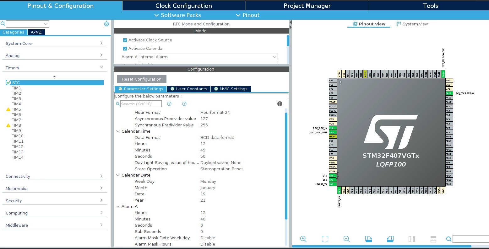

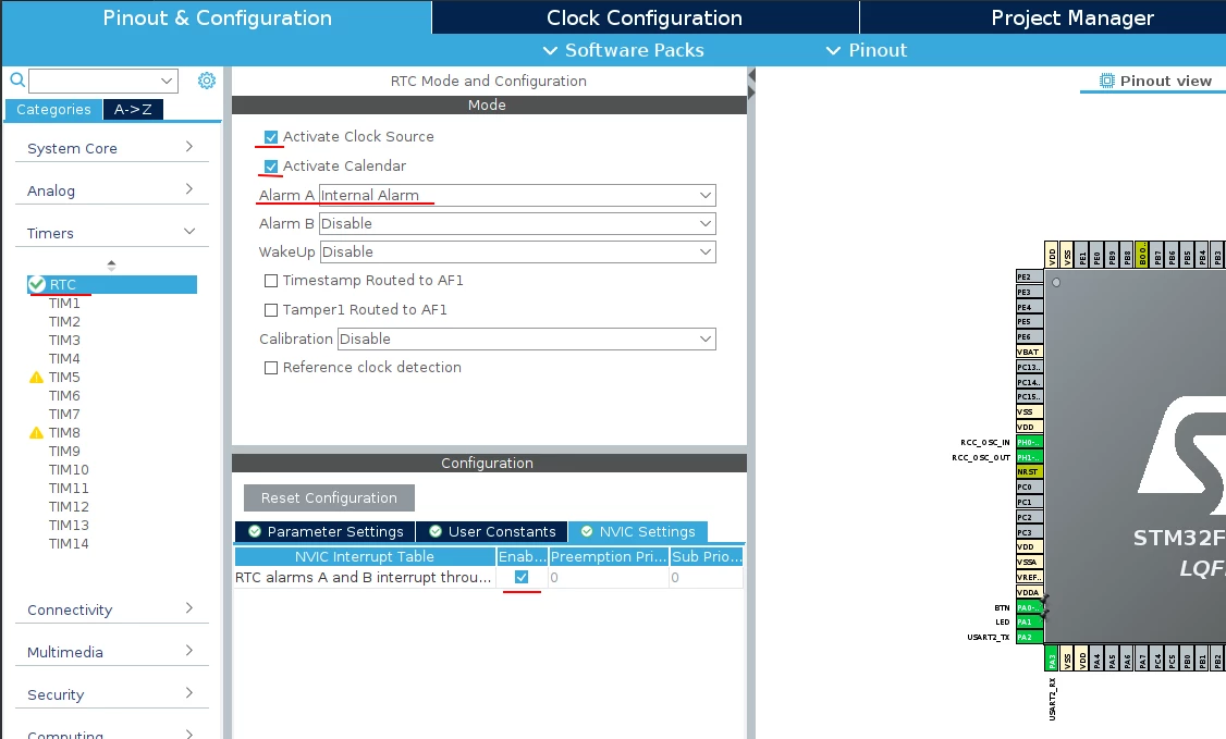

Thanks for the answer, I looked at the example but did not find solutions!
I thought if I will activate the interrupt for alarm of RTC and in the code to call the desired Callback, then the alarm clock will work ... But, not in my case and I do not understand why it is don work!
I will give any information. I just don't know what exactly you need to show. 0693W00000FD2LCQA1.png

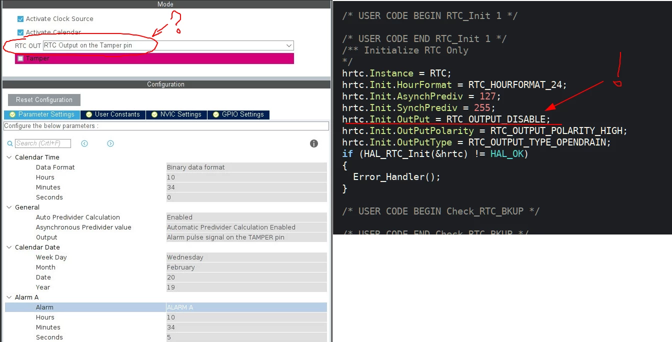

I think the reason why my alarm clock do not work, it is because, I do not have some setting!?!? see screenshot.
And so I have "RTC_OUTPUT_DISABLE" in my the code.

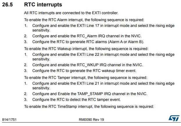

Have you connected the EXTI line 17 to the RTC Alarm event ?
Did you set the following sequence correctly? (to enable the RTC Alarm interrupt)
DK.7
DK.7Author
October 19, 2021
No, and I do not know how to do it!
