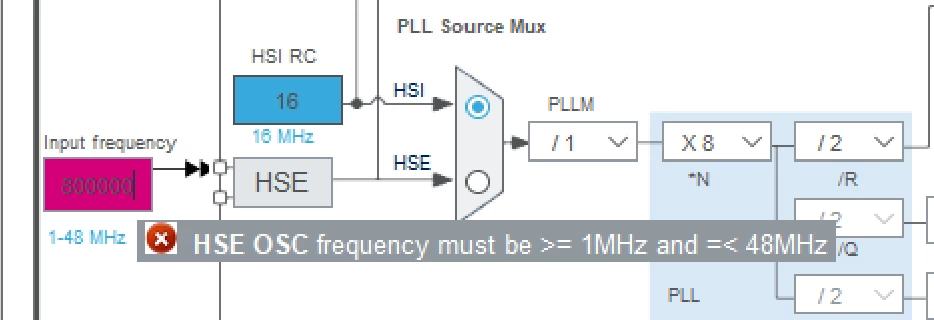

There is a bug that haunts me since I started using Cube, which was 2017. It is very simple: for some reason in Clock Configuration panel whenever I touch any of the Input frequency fields, the value I am leaving in there gets divided by 1000000 (one milion). The workaround was to put the intended value multiplies by milion.
It happened in all versions of Cube I tried (I am updating Cube regularly). I am using Cube as Eclipse plugin or the modified Eclipse called System Workbench for STM32 (SW4STM32).
I recall reporting it at least once before, still it wasn't fixed - only made worse, as LSE field was blocked from being edited at some point, which made perfect sense, as only one value was accepted - but not if the field is given an incorrect value by Cube itself! Now Cube is constantly screaming at me that my project has a problem in Clock configuration, which was created by the Cube and I am prohibited from changing anything. That's ********.

In general, SW4STM32 was abandoned years ago. I don't expect anything to be fixed in there.
I can't reproduce the bugs you mention. Certainly putting in 8000000 instead of 8 as the HSE frequency works, but CubeMX correctly reports that it's invalid. Putting in 8 works just fine.

For me the LSE field looks like this and I can't change it at all - I can reproduce same effect on HSE field by just typing "8" and pressing enter few times.

No warning with this input value? The classical question: are you using latest CubeMX version?

Of course there is a warning, that's what this post is about. It constantly pops warnings that clock configuration is messed up and I can't do anything about it.
It's the latest version of plugin SW4STM32 could find - I've found an update and installed it to check if this would solve the problem right before going to the forums.
