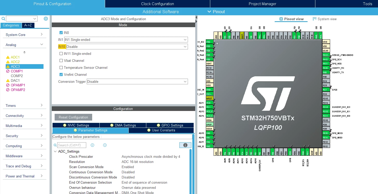

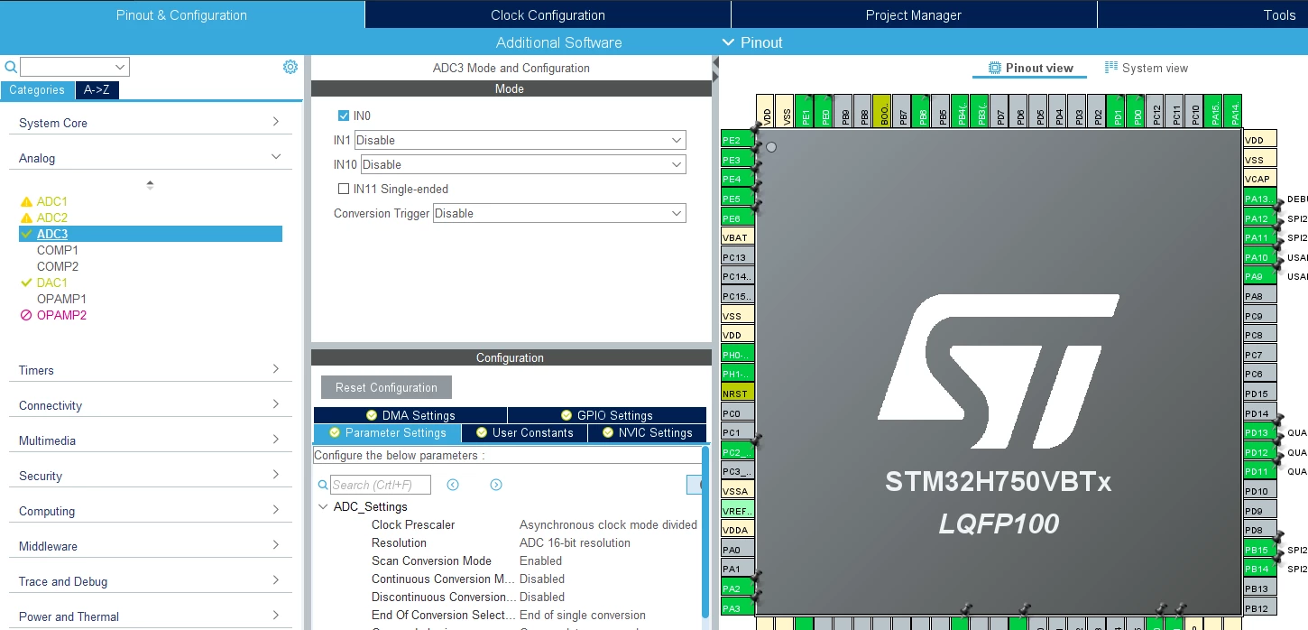

why are vbat, vrefint and temp ADC3 channels on STM32H7 no longer available on the latest CubeMx version? I'm I missing another conifguration to make them available?
screenshot from an .ioc file created with an earlier version of CubeMx
CubeMx version 5.30
screenshot from an .ioc file created with CUbeMx version 5.5.0

​Hello @Sebastiain Fernandez​ ,
Issue has been fixed , the fix will be available in the next release.

Hi I just found that the problem is in fact related to the STM32CubeH7 firmware package 1.6.0.
I downgraded to version 1.5.0 with CubeMx 5.5.0 and the ADC3 vbat, temp and vrefint channels are available
