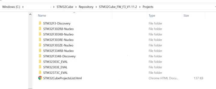

Actually, the Example selector allows you to browse a large set of examples and to start a new project from a selected example but only for some STM32 MCUs/MPUs.
Hence, you may not be able to start your project from an already developed project for F3 series using STM32CubeMX/STM32CubeIDE since the STM32F3 examples are not available in Example Selector tab (same for F0/F1/F2).
You can install the STM32Cube MCU package for F3 series ( or for other series). This package comes with a rich set of examples running on STMicroelectronics boards. The examples are organized by board, and are provided with preconfigured projects for the main supported toolchains:
You'll find a table resuming the available examples in the STM32Cube firmware examples for STM32F3 Series Application Note.
Noting that there is no STM32CubeMX project for those examples.
