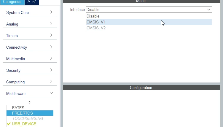

Scott Dev
Scott DevAuthor
Senior
September 24, 2019
Hi
Many thanks for your reply. Attched is the drop down list of the interface, and it doesnt have freeRTOS. I read some place that there should be a selection for freeRTOS too.
Best Regards
Scott

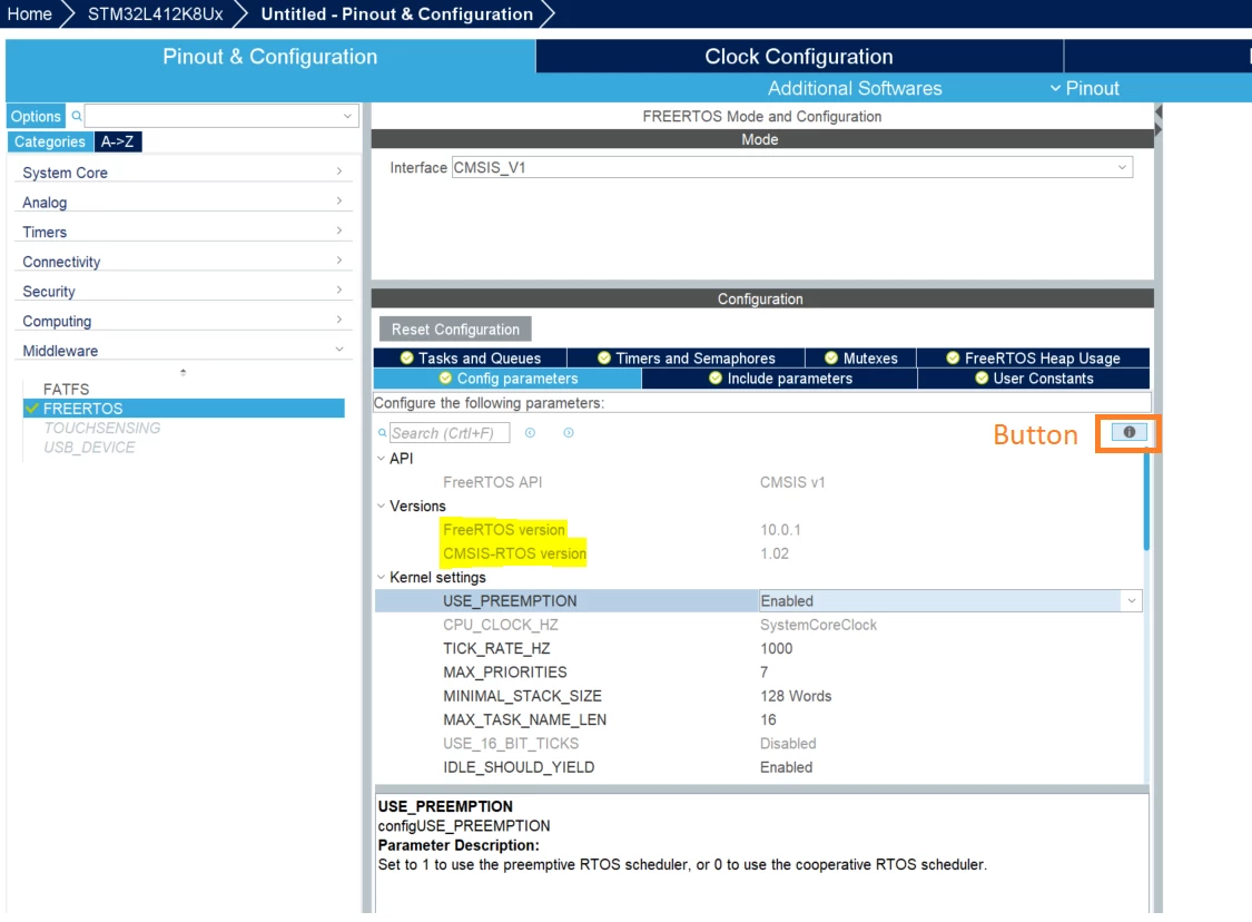

Khouloud ZEMMELI
September 25, 2019
​Hello @Scott Dev​  ,
To enable Freertos you should select one of the 2 version of CMSIS (CMSIS_V1 or CMSIS_V2) and depending on the availability.
Then, you can find under configuration-Config parameters versions of FreeRTOS and CMSIS and they depend on MCU and CubeMX version, also there is a button that can help you to use  parameters .
Best Regards,
Khouloud.
Piranha
Principal III
September 25, 2019
Underneath ST's bloatware it is the same normal FreeRTOS, but ST have made CMSIS-RTOS wrappers to it and CubeMX uses FreeRTOS only through these.
