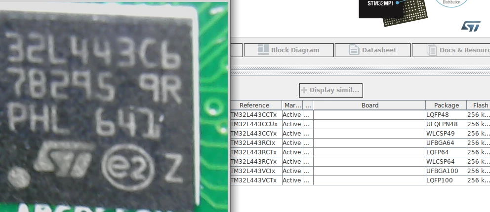

Which chip to select for STML443C6
  • May 28, 2019
  • 1 reply
  • 855 views
I dont know which chip to select for STML443C6 on StcubeMX.
Thank you.
1 reply
Tesla DeLorean
Guru
May 28, 2019
Use the dimensions to pick the BGA which matches so the pin configuration has the correct rational, and then adjust the RAM/FLASH on the linker script or project side when done.
Speak to your local FAE or sales rep about things which are engineering samples, or prereleased/custom built.
