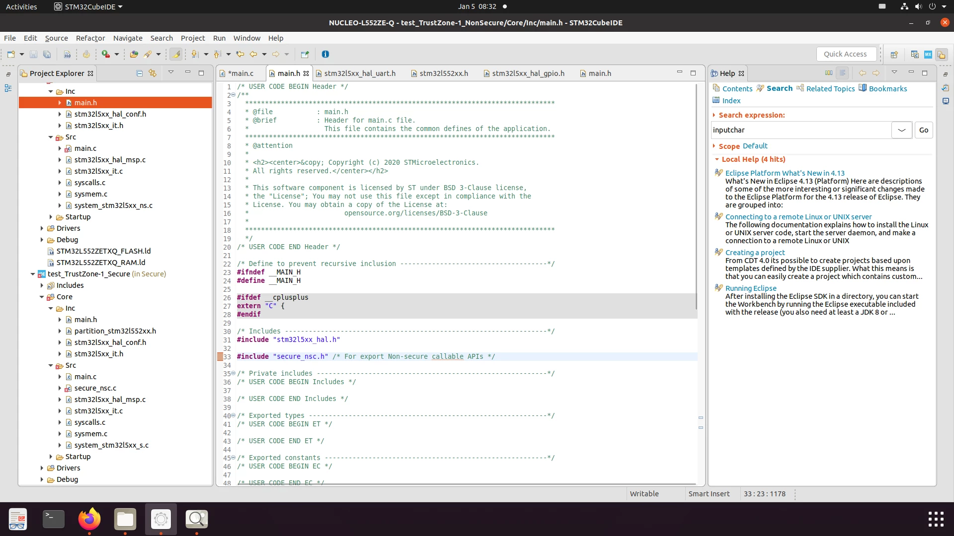

Where is the "stm32l5xx_hal.h"?
I made a project based on NECLEO STM32L552ZE-Q, when I made it from MX configuration tool, I found there was no "stm32l5xx_hal.h", while it was included in main.c, where could I find it?0693W000006HUTzQAO.png

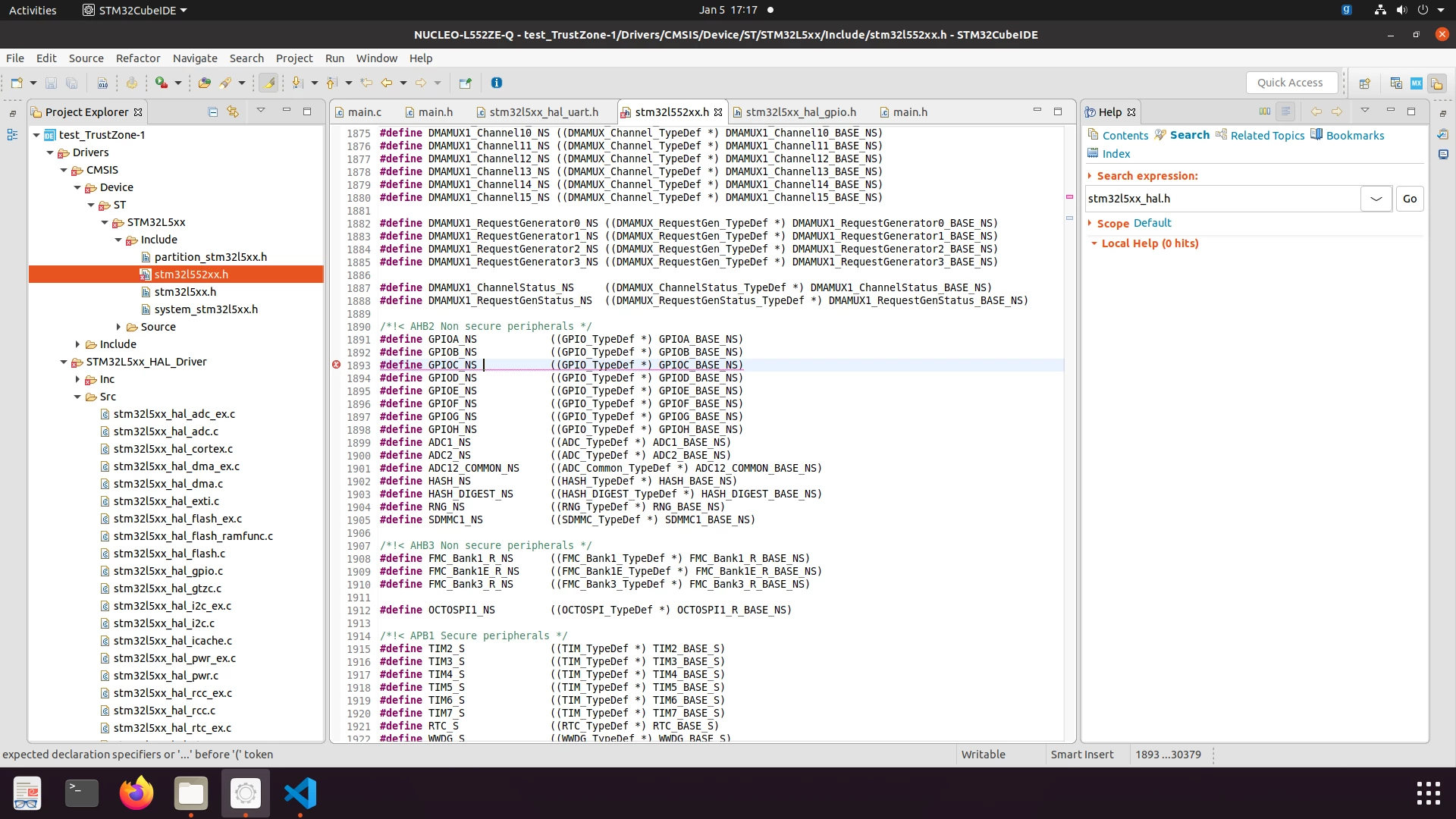

here is the prompt in console:
08:39:20 **** Incremental Build of configuration Debug for project test_TrustZone-1_NonSecure ****
make -j8 all
arm-none-eabi-gcc "../Core/Src/main.c" -mcpu=cortex-m33 -std=gnu11 -g3 -DUSE_HAL_DRIVER -DSTM32L552xx -DDEBUG -c -I../Core/Inc -I../../Secure_nsclib -I../../Drivers/STM32L5xx_HAL_Driver/Inc -I../../Drivers/CMSIS/Device/ST/STM32L5xx/Include -I../../Drivers/STM32L5xx_HAL_Driver/Inc/Legacy -I../../Drivers/CMSIS/Include -O0 -ffunction-sections -fdata-sections -Wall -fstack-usage -MMD -MP -MF"Core/Src/main.d" -MT"Core/Src/main.o" --specs=nano.specs -mfpu=fpv5-sp-d16 -mfloat-abi=hard -mthumb -o "Core/Src/main.o"
In file included from ../../Drivers/CMSIS/Device/ST/STM32L5xx/Include/stm32l5xx.h:98:0,
 from ../../Drivers/STM32L5xx_HAL_Driver/Inc/stm32l5xx_hal_def.h:34,
 from ../../Drivers/STM32L5xx_HAL_Driver/Inc/stm32l5xx_hal_rcc.h:29,
 from ../Core/Inc/stm32l5xx_hal_conf.h:246,
 from ../../Drivers/STM32L5xx_HAL_Driver/Inc/stm32l5xx_hal.h:30,
 from ../Core/Inc/main.h:31,
 from ../Core/Src/main.c:21:
../../Drivers/CMSIS/Device/ST/STM32L5xx/Include/stm32l552xx.h:1893:29: error: expected declaration specifiers or '...' before '(' token
 #define GPIOC_NS ((GPIO_TypeDef *) GPIOC_BASE_NS)
../../Drivers/CMSIS/Device/ST/STM32L5xx/Include/stm32l552xx.h:2631:40: note: in expansion of macro 'GPIOC_NS'
 #define GPIOC GPIOC_NS
../Core/Inc/main.h:72:29: note: in expansion of macro 'GPIOC'
 #define LED_GREEN_GPIO_Port GPIOC
../Core/Src/main.c:55:20: note: in expansion of macro 'LED_GREEN_GPIO_Port'
 HAL_GPIO_TogglePin(LED_GREEN_GPIO_Port, LED_GREEN_Pin);
In file included from ../Core/Inc/stm32l5xx_hal_conf.h:250:0,
../../Drivers/STM32L5xx_HAL_Driver/Inc/stm32l5xx_hal_gpio.h:92:36: error: expected declaration specifiers or '...' before '(' token
 #define GPIO_PIN_7 ((uint16_t)0x0080) /* Pin 7 selected */
../Core/Inc/main.h:70:23: note: in expansion of macro 'GPIO_PIN_7'
 #define LED_GREEN_Pin GPIO_PIN_7
../Core/Src/main.c:55:41: note: in expansion of macro 'LED_GREEN_Pin'
../Core/Src/main.c: In function 'main':
../Core/Src/main.c:103:41: error: 'InputChar' undeclared (first use in this function)
 while (HAL_UART_Receive (&hlpuart1, &InputChar, 1, 1000) == HAL_OK)
../Core/Src/main.c:103:41: note: each undeclared identifier is reported only once for each function it appears in
../Core/Src/main.c:105:22: error: 'Status' undeclared (first use in this function); did you mean 'ITStatus'?
 if (InputChar != Status)

Jan 5, 2021 1:41 AM UTC
It shows right in the console output:
The "Drivers" folder is a top-level folder within your project.
You've got some other usage errors happening. HAL_UART_Transmit requires a pointer, a length, and a timeout value. You're just trying to pass a raw string, which isn't even the right number of arguments.

Yes, I found it, but the others are all set the same way, since this pin I used, so does that mean the configuration would rewrite the file "stm32l5xx_hal.h", and so my configuration has errors?

Now, it shown:"../Core/Src/main.c:121:28: error: 'hlpuart1' undeclared (first use in this function)", should I declared a "hlpuart1" object of "HLPUART" in main.c or main.h? Since I hasn't found it in " ../../Drivers/STM32L5xx_HAL_Driver/Inc/stm32l5xx_hal.h".
MQi.1
MQi.1Author
Senior II
Jan 18, 2021 11:53 PM UTC
for "Double check what modules are enabled in your project's stm32l5xx_hal_conf.h", I found these, is it enough?
#ifdef HAL_UART_MODULE_ENABLED
 #include "stm32l5xx_hal_uart.h"
#endif /* HAL_UART_MODULE_ENABLED */
#ifdef HAL_USART_MODULE_ENABLED
 #include "stm32l5xx_hal_usart.h"
#endif /* HAL_USART_MODULE_ENABLED */
Jan 19, 2021 12:14 AM UTC
HAL is open source, you can look at the source files directly to see how to use them. F3 will jump to the definition. There are also quite a few examples in the CubeMX repository that you can look at, although the L5 is relatively new and may not have as many as the other families.
If you enable these things within CubeMX, it will generate the code you need to run them, such as the definition of hlpuart1. That would probably be the easiest method to get started.
As far as what modules are enabled, your code snippet doesn't provide that info. Are the HAL_UART_MODULE_ENABLED and HAL_USART_MODULE_ENABLED #defines enabled? They would be higher up in that file.

Jan 20, 2021 3:08 PM UTC
> But I could not fine the file"stm32l5xx_hal_conf.h", although I could find file "stm32l5xx_hal.h" there.
It's shown in the screenshot in your very top post. You're going to need to try a little harder here if you want to solve issues.

Jan 20, 2021 8:51 AM UTC
OK, I found it, it was here:
/...(project name)/Core/Inc/stm32l5xx_hal_conf.h

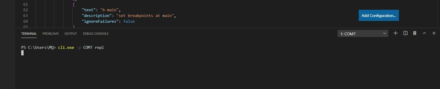

Jan 20, 2021 9:30 AM UTC
I just tested in VS Code, it was said COM7 connected, no problem no error, but I just could input into it, and could see output from board in it.0693W000007BxOHQA0.jpg
