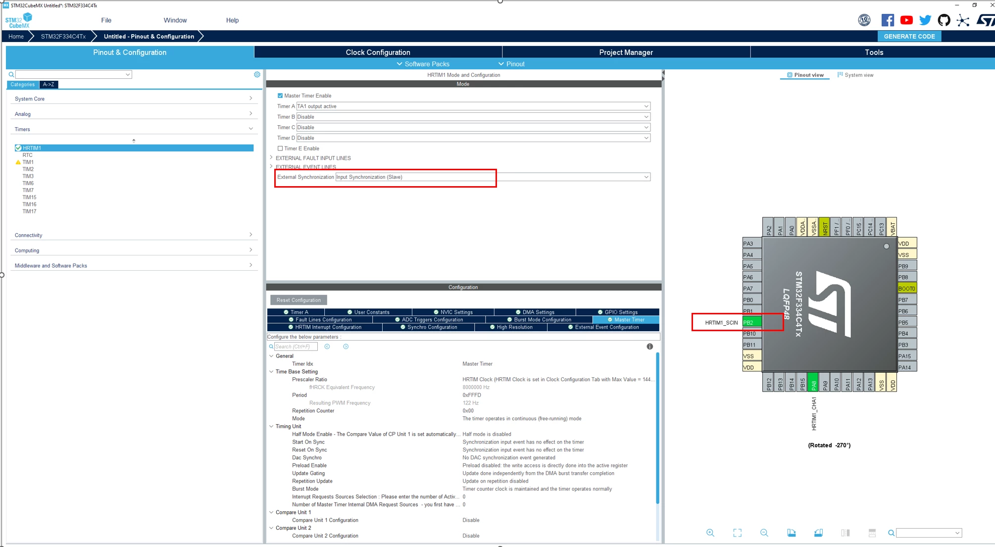

where in the cubemx I can activate HRTIM_SCIN?
I am using stm32f334. it has hrtim timers. based on its manual it also has HRTIM_SCIN. but I don't know where should I find its setting in the CubeMX to activate it

    Hello @MJavi.1
    To activate the HRTIM_SCIN in CubeMX for STM32F334, follow these steps:
    1- Open CubeMX and create a new project for your STM32F334 microcontroller.
    2- Under [Timer] Activate HRTIM
    3- External Synchronization : choose Input Synchronization
    Thx
