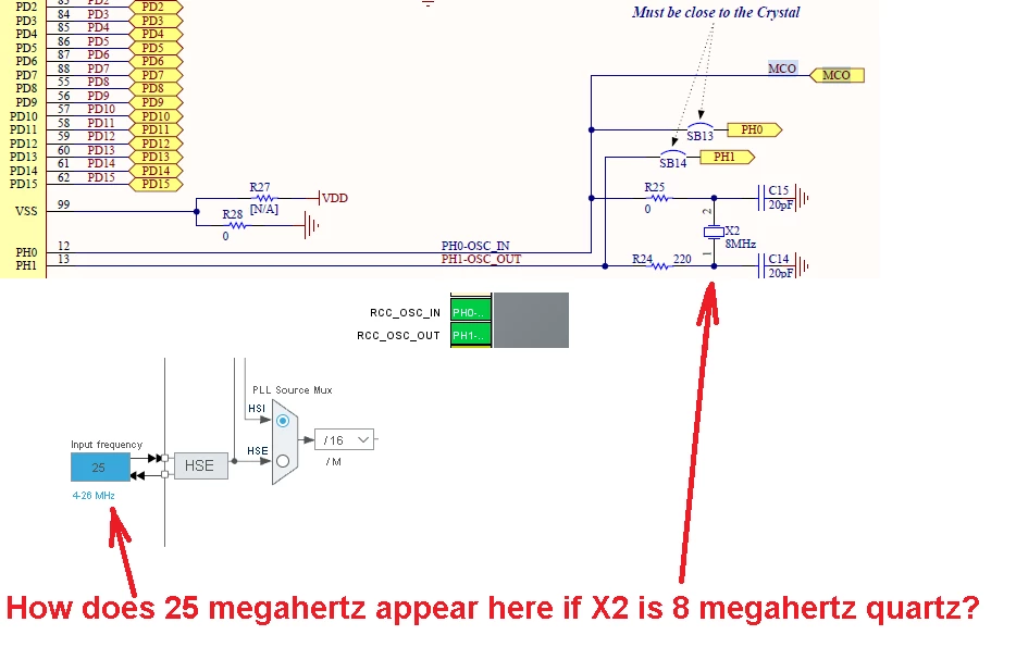

Where can I measure 25 megahertz intended for HSE?
STM32F407 Discovery
en.MB997-F407VGT6-C01_Schematic.pdf
_legacyfs_online_stmicro_images_0693W00000biD0jQAE.pngHSE quartz 8 megahertz.
How are 4-26 MHz generated for HSE?
With an oscilloscope, I see only 8 megahertz on X2 quartz.
Where are those 25 megahertz that are listed as input for HSE?
In the documentation I read this:
This frequency cannot be changed, it is fixed at 8 MHz and connected to PH0-OSC_IN of the STM32F407VG.
But in Cube Mx this frequency can be changed from 4 to 26 megahertz.
on a board with 25MHz crystal (i have one of these here)
how should Cube know, what crystal you decide to use ???
exactly. until you solder another crystal there in. then set this new frequency in Cube!
