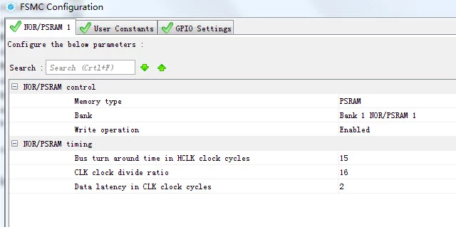

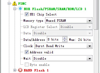

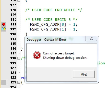

when i am use stm32f407VE fsmc muxed psram, cortex-M error occurred
​Choice clock disable, the is No problem.
#define FSMC_CFG_ADDR ((unsigned char *)0x60000000) //

The problem has been solved.
when you are use clock Burst read write,
the wait signal must be turn on .
stm32f4 stm32f2 also have the same problem.
stm32f7 is no this problem.

Apr 5, 2019 1:49 PM UTC
Check your pins settings, if the pins used for the JTAG/SWD debug interface
Regards,
Imen
