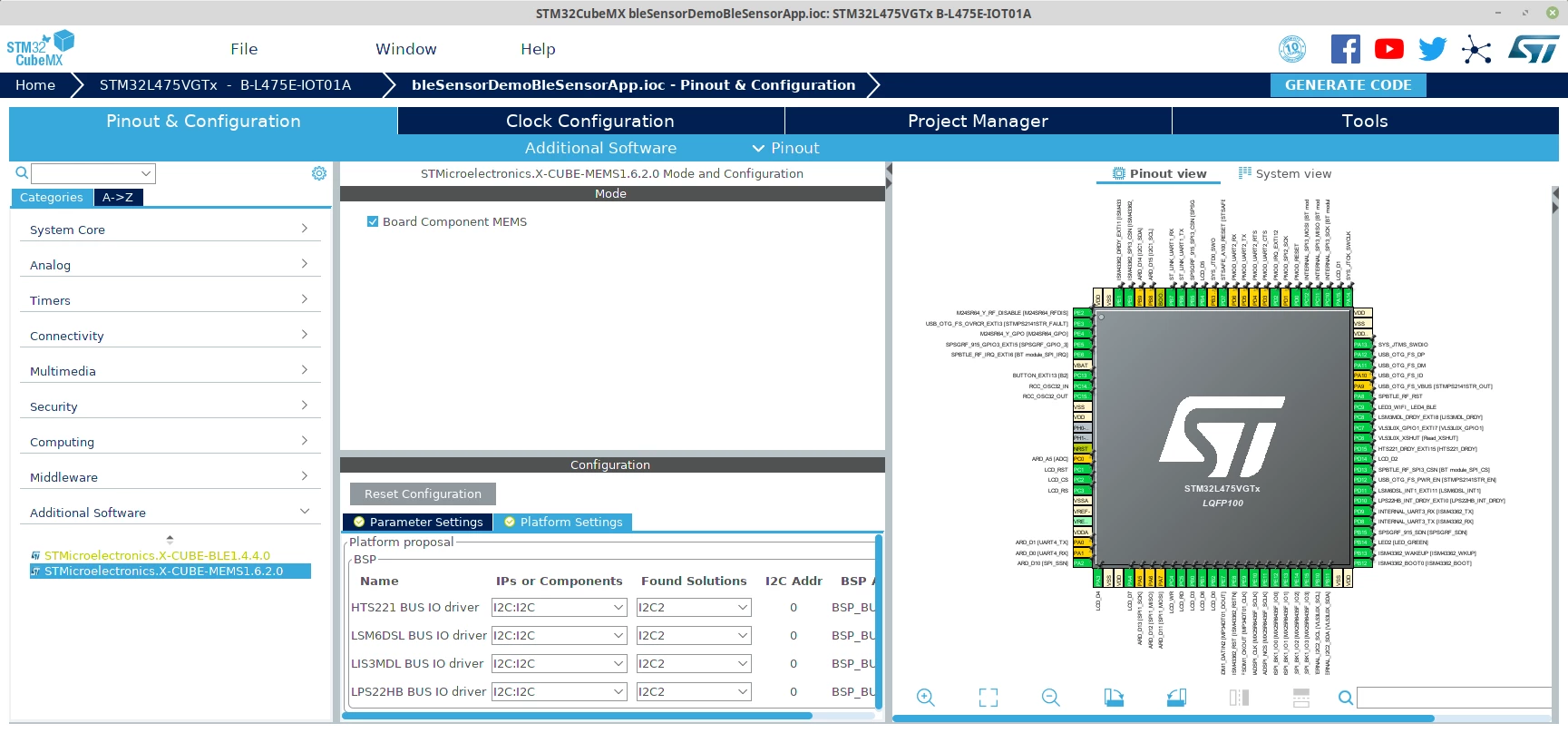

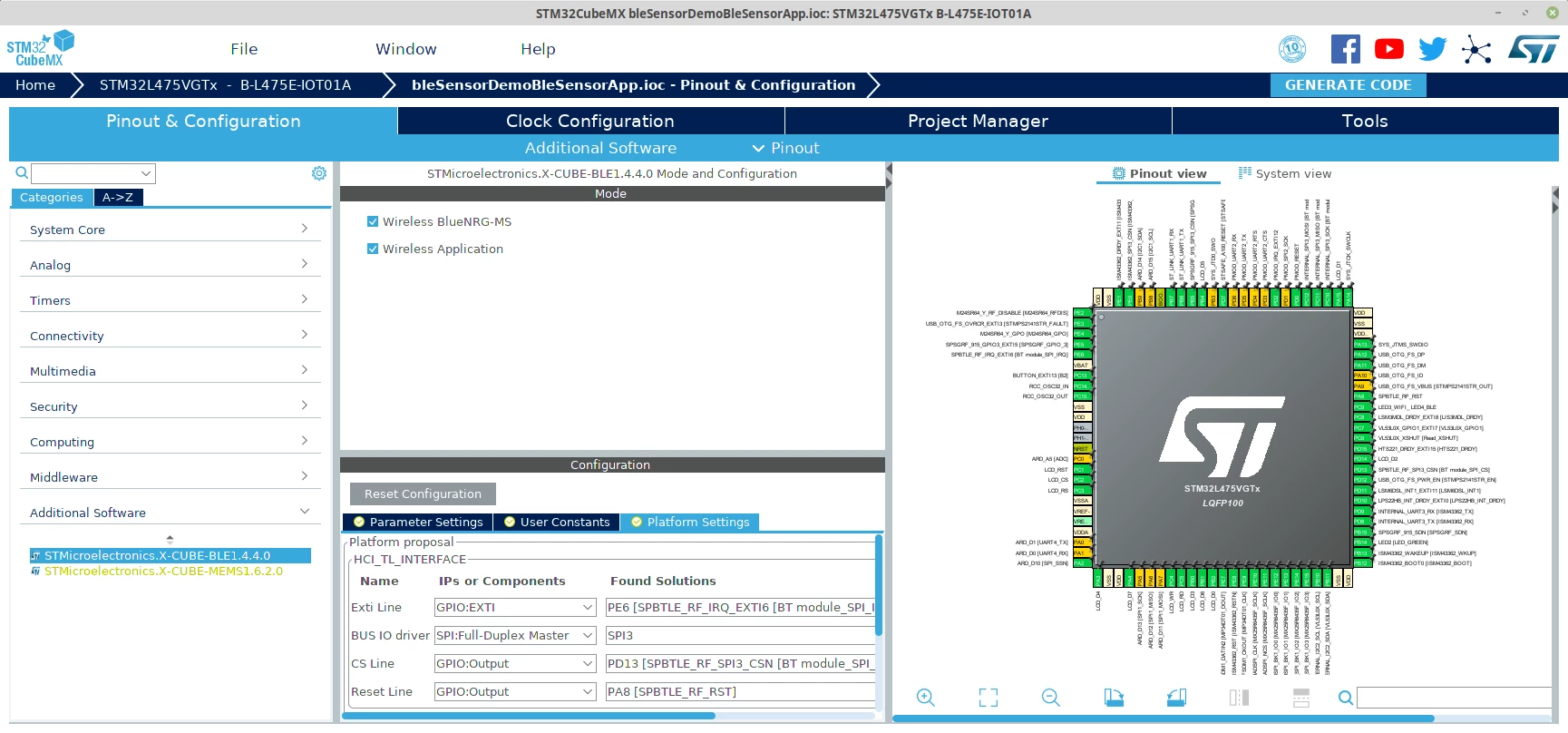

When I add the MEMS component software to a BLE software project that has successfully compiled cubemx removes the bluenrg software from its directory in the subsequent build. How can I use these together? (Using Atollic 9.2.0 and cubemx5.2.1)

My solution is to generate the project with just BLE. Use file manager to copy the BlueNRG-MS directory to somewhere else. When selecting any MEMs modules and regenerating the code it will empty the BlueNRG-MS directory. Copy the contents of the saved one back and good to go.
