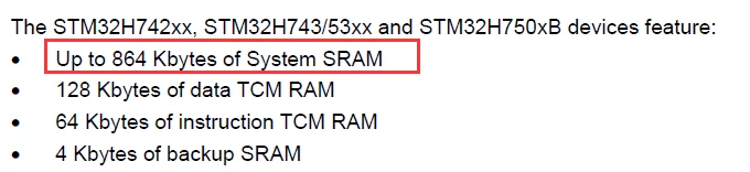

 <1> Recently I noticed the important of the Linker setting when I configured USB support(Someone say that need to increase the value in case of going wrong).
  So I am wondering how large I could set.How does it relate to System SRAM or somthing else?

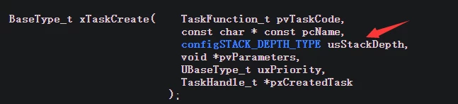

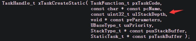

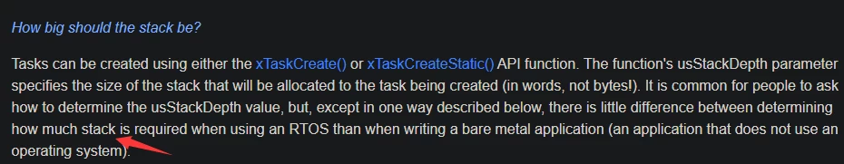

<2>I am also a FreeRTOS new user.I was told I should set a large stack when create a task in the first time.
But how maximum I could set?  All task stack add up can not be more than what?
  Does someone know or think about these questions?

The board uses RAM for variables, the heap, and the stack. You can divide the available memory however you want among those three.
In general, the size allocated to the stack is a small portion of the overall memory, maybe 4 kB at most, but there is no explicit limit.
The static stack analyzer in STM32CubeIDE (Window -> Show View -> Static Stack Analyzer) can give you an idea of the amount of stack needed for each task. In the Call Graph tab, the Reset_Handler function will give you the max stack size of the main thread. In general, functions shouldn't be using more than maybe a couple hundred bytes of stack, and typically much much less, but again there is no explicit limit here.

  Got it.I should set Minimum Heap and Stack Size together 4KB at most,create a task with a hundred bytes at first and resize it by static stack analyzer.
