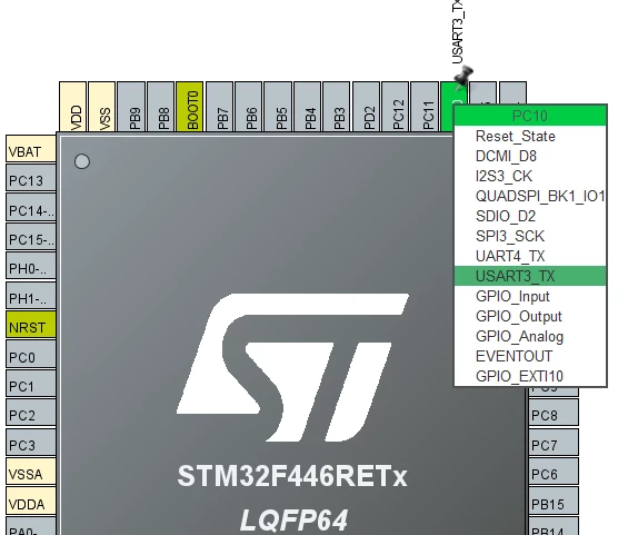

Now, if you want to use the PC10 as pin for the USART3_TX signal, you have just to click on PC10 and choose the USART3_TX (before the activation of the USART IP or even after).

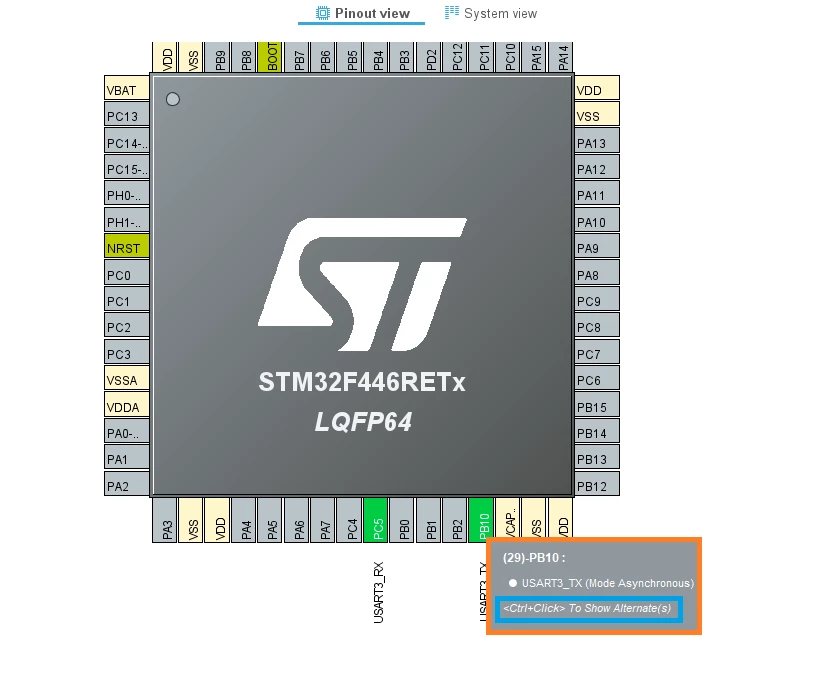

I would like to take this opportunity to present you another way to know the possible Pins that can be remapped instead of other pins for a signal used, without referring to DS and directly through the Pinout view of the CubeMX interface, you need just to put the cursor on pin (which has already a signal on it) and press CTRL+Click, then CubeMX will give you all possible pins which contain the same signal (Alternates) :
