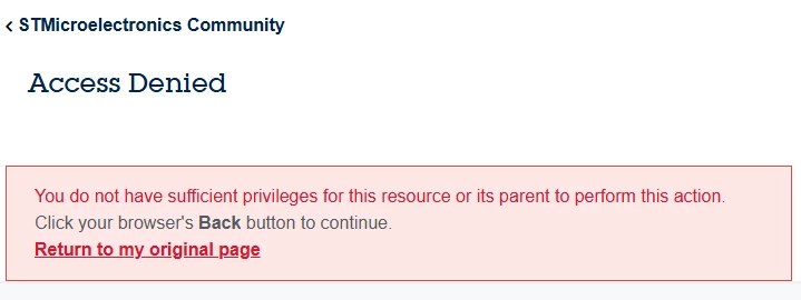

BMcDo.3
August 29, 2025
@waclawek.jan wrote:
Note, that ST pushes Cube, mostly in its HAL form, and refuses to work on register based examples.
That link is broken.
