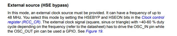

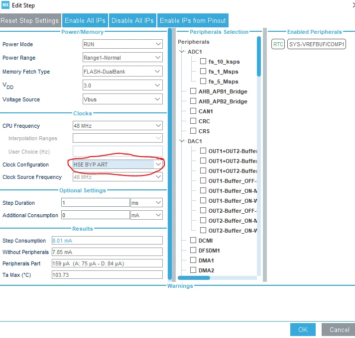

I'm currently working with the Power Consumption Calculator of STM32 and trying to configure the correct settings for my STM32L4R and was wondering what "HSE BYP Art" mean in the options and where I can find that in the ref. manual.
That's what I found in the reference manual about HSE bypass. Also I'm a little irritated, because I do not use any external clocks, as far as I know. As it seems, there is no way to disable this setting in the calculator.
