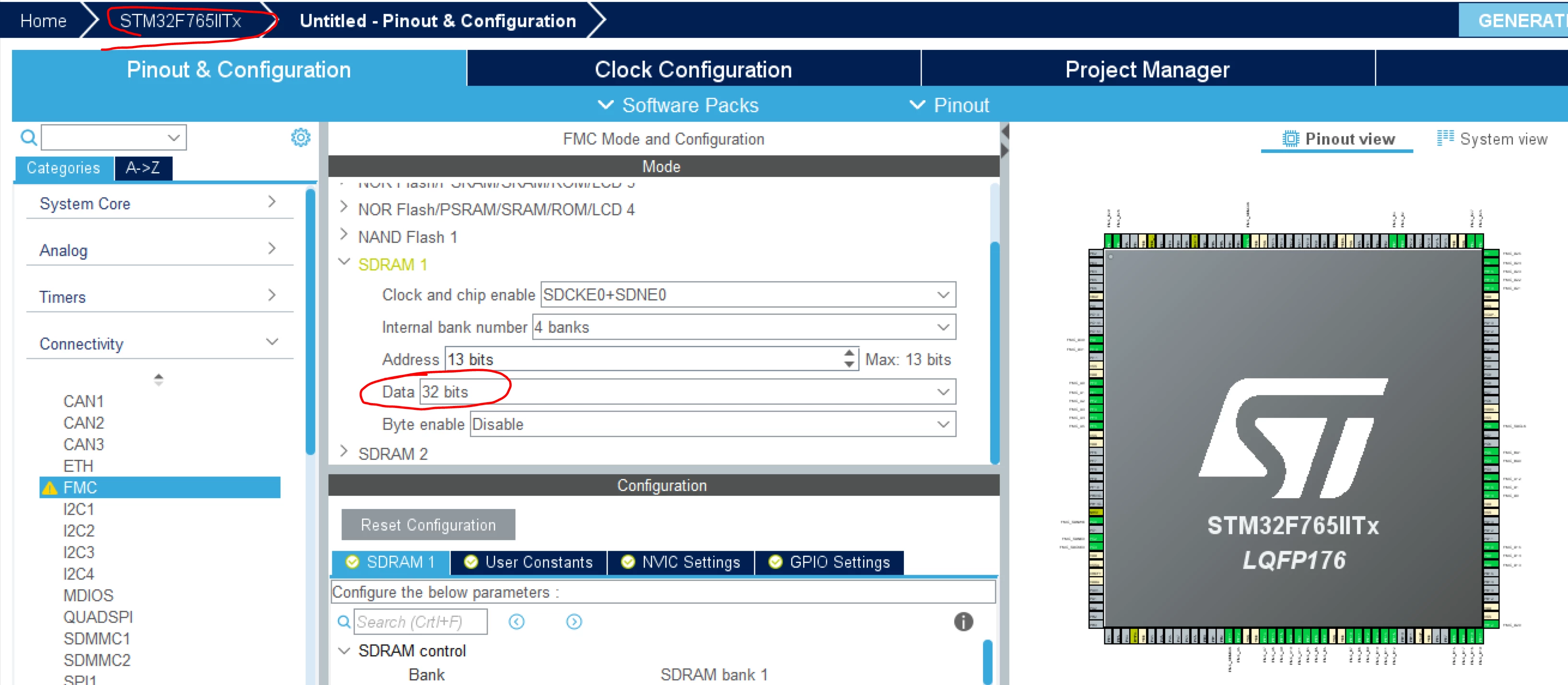

What am I missing: STM32CubeMX/STM32CubeIDE Limited to 16bit data with STM32F765IITx (LQFP176).
I selected the LQFP176 package, because the datasheet expresses a 32bit data bus. However, ST development tools are limiting me to 16bit. Has anybody taken the generated 16bit code and expanded it to 32bit or would I be wasting my time? Thank you for any feedback.

Nov 28, 2020 11:43 PM UTC
Works for me with SDRAM. Not all memory types support 32-bits. Provide more info on what you're trying to do.

Thank you for reaching out!!! I also dug a little deeper into the flash I'm trying to interface with (a SIMM of 8 x AM29DL323DB, with the chip selects tied to pairs/32bit data). I was mistakenly stuck on NAND flash for some reason (limited to 16bits); but the STM32 NOR interface, fits the bill much better! I'll be more careful/patient before asking questions in the future. Thank you for your time!
