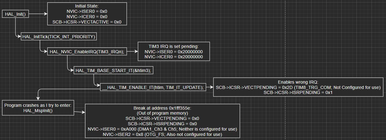

I think I fix the issue and then it randomly pops back to ruin my day about every 2-4 days. The problem first manifest itself in my project as I was trying to get a one-shot timer configured. Since then I have observed enough to be 97% convinced that this is an interrupt configuration issue with MxCube, but as I debug the code and analyze the auto-generated code by MxCube everything seems correct.
The cycle goes like this. I have to make some change to MxCube for various reasons like deleting a mutex or queue from FreeRTOS or adjusting settings with DMA or ADC interrupts. The ADC and DMA interrupts that I crawled through was the worst of all and I have since abandoned any hope of being able to use DMA and/or ADC interrupts at all. I have also noticed a very strong correlation with the previously mentioned one shot timer. This peripheral cannot be scrapped from my project.
Anyways, every time the bug comes back the behavior is the same. I run my code in the IDE via debug mode. The program enters HAL_Init() and right after the timebase timer (TIM3, but I've tried several others) IRQ is enabled I notice 3 interrupts become pending that were never configured (DMA1_ch3, DMA1_ch5, & OTG_FS). Its like the MCU just totally looses it. I made the following flow chart to illustrate what I see as I debug it.
So then I wrestle around with the NVIC tab within MxCube for hours or days and then the problem just goes away and everything is fine. It is like the MCU is possessed with evil spirits. I've never seen anything like this.

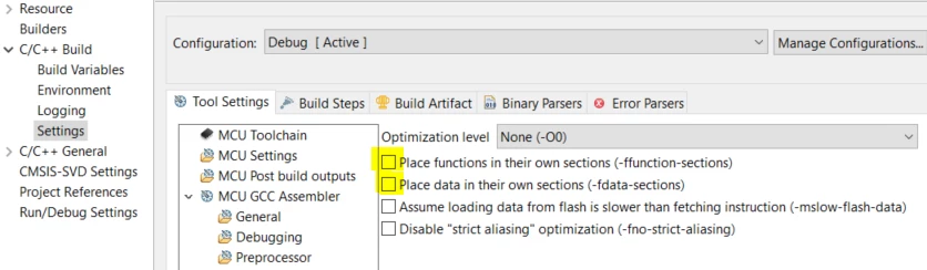

I think I fixed the issue. I went into project properties (settings) and unchecked the following two flags under compiler optimization:
  • Place functions in their own sections
  • Place data in their own sections

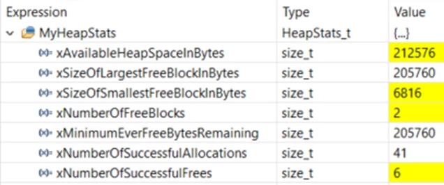

0693W00000NpO1MQAV.pngI thought to do this because after analyzing my heap usage I notice that I have lots of heap and because I know the size of RAM on this CPU I know that I should have LOTS of space for stack. The only other explanation is how that memory is being utilized by the compiler. Notice that I have lots of RAM but I am out of FreeBlocks.

> break at address 0x1fff'xxxx
Bootloader/PEMPTY-related, this issue comes up here a lot, often related to 'L4+
See the end of this thread:
https://community.st.com/s/question/0D53W00000raYd2SAE/intermittent-break-at-address-0x1fff51f4-with-no-debug
