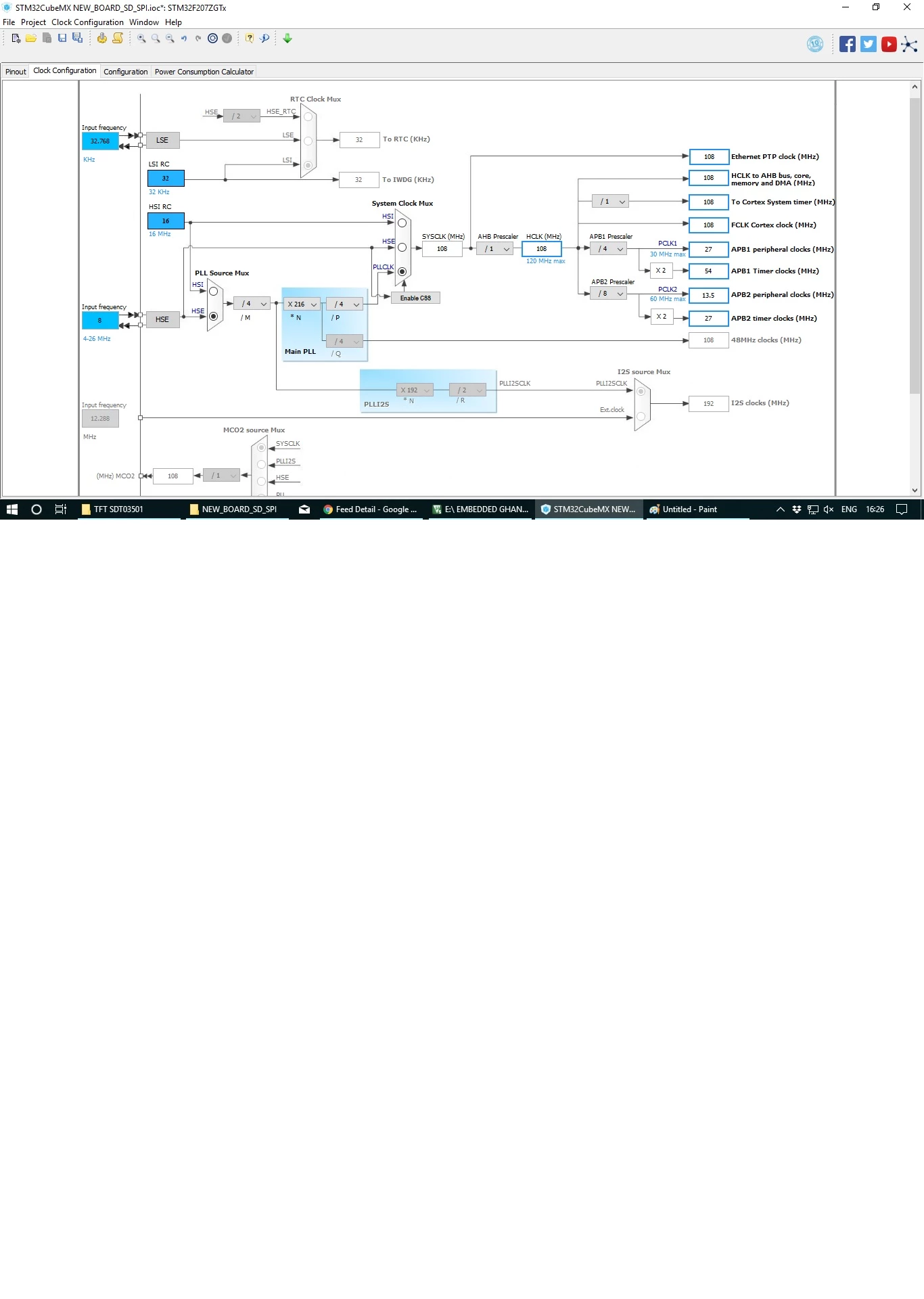

LACTIC
LACTICAuthor
Apr 13, 2019 10:56 AM UTC
System clock settings :-
void SystemClock_Config(void)
 RCC_OscInitTypeDef RCC_OscInitStruct;
 RCC_ClkInitTypeDef RCC_ClkInitStruct;
  /**Initializes the CPU, AHB and APB busses clocks
 RCC_OscInitStruct.OscillatorType = RCC_OSCILLATORTYPE_HSE;
 RCC_OscInitStruct.HSEState = RCC_HSE_ON;
 RCC_OscInitStruct.PLL.PLLSource = RCC_PLLSOURCE_HSE;
 RCC_OscInitStruct.PLL.PLLM = 4;
 RCC_OscInitStruct.PLL.PLLN = 216;
 RCC_OscInitStruct.PLL.PLLP = RCC_PLLP_DIV4;
 RCC_OscInitStruct.PLL.PLLQ = 4;
  _Error_Handler(__FILE__, __LINE__);
 RCC_ClkInitStruct.APB1CLKDivider = RCC_HCLK_DIV8;
 RCC_ClkInitStruct.APB2CLKDivider = RCC_HCLK_DIV2;
 if (HAL_RCC_ClockConfig(&RCC_ClkInitStruct, FLASH_LATENCY_3) != HAL_OK)
  /**Configure the Systick interrupt time
 HAL_SYSTICK_Config(HAL_RCC_GetHCLKFreq()/1000);
 HAL_SYSTICK_CLKSourceConfig(SYSTICK_CLKSOURCE_HCLK);
 /* SysTick_IRQn interrupt configuration */
 HAL_NVIC_SetPriority(SysTick_IRQn, 0, 0);
LACTIC
LACTICAuthor
Apr 13, 2019 10:57 AM UTC
cubmex clock config window.
