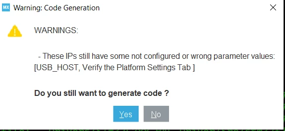

Warning during STM3CubeMX setting in USB_HOST on Platform Setting Tab
Hi ,
I want to setup my STM32F769 Discovery board as USB Host. I use STM32CubeMX :
Middleware-> USB_HOST-> Class For HS IP: Mass Storage Class.
But when I generate the code, it gave me pop up warning as following. What does this warning mean? And how should I resolve it?

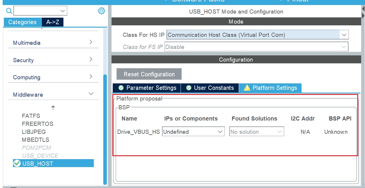

Thank you for having reporting. Normally, as indicated by the warning message there is a missing configuration in the USB_HOST > Configuration panel > Platform Settings tab in STM3CubeMX:
0693W00000AMtKyQAL.pngPlease complete the Drive_VBUS_HS configuration and try to re-generate the code.
Otherwise, when clicking the Yes button in displayed warning pop up, the project will be generated anyway.

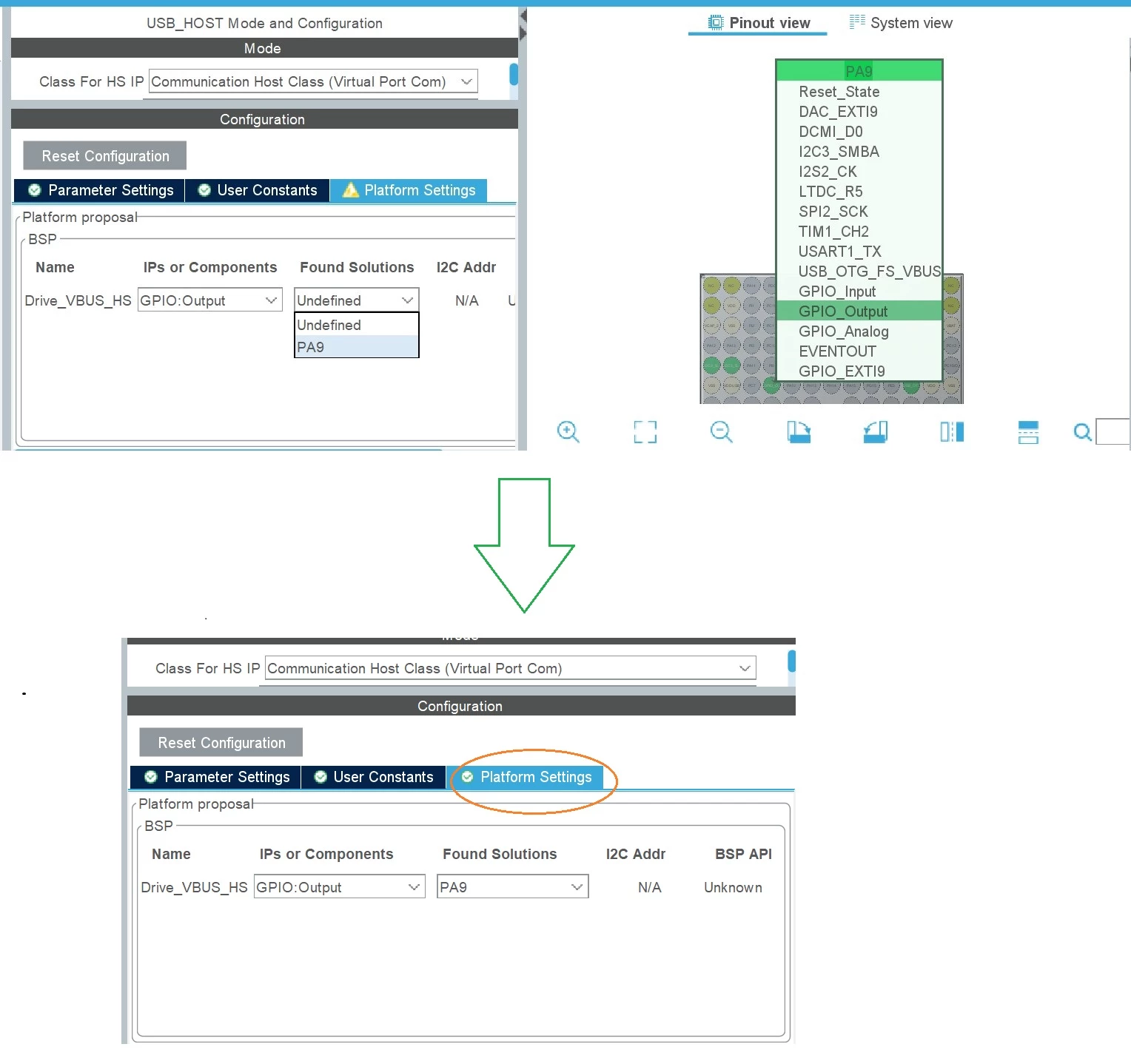

Actually one of the OTG_FS/OTG_HS interface in host-mode features is the external charge pump for VBUS voltage generation, in other words the VBUS pin is used to power any connected peripheral by supplying power from USB host.
Noting that, on-chip 5 V VBUS generation is not supported. For this reason, a charge pump or, if 5 V are available on the application board, a basic power switch must be added externally to drive the 5 V VBUS line. The external charge pump can be driven by any GPIO output. This is required for host-only configuration. Please refer to STM32F7 Reference Manual for more details about Host port power.
Hereafter screenshots showing an example, where I configured PA9 on a STM32F7 as a GPIO_Output:
0693W00000ANH12QAH.jpgHaving a look at the generated code by CubeMX, once the Platform Settings are correctly configured, a file implementing the USB platform will be generated: usbh_platform.c
void MX_DriverVbusHS(uint8_t state)
 uint8_t data = state;
 /* USER CODE BEGIN PREPARE_GPIO_DATA_VBUS_HS */
 if(state == 0)
 /* Drive high Charge pump */
 data = GPIO_PIN_SET;
 else
 /* Drive low Charge pump */
 data = GPIO_PIN_RESET;
 /* USER CODE END PREPARE_GPIO_DATA_VBUS_HS */
 HAL_GPIO_WritePin(GPIOA,GPIO_PIN_9,(GPIO_PinState)data);
If you click the Yes button in displayed warning pop up (without completing the platform settings), the project will be generated without any problems but the usbh_platform.c file will not be generated.
