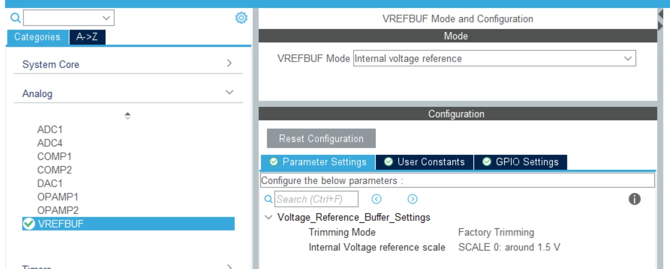

In the original project, VREFBUF was set to ‘Internal voltage reference’ mode with ‘SCALE0’.

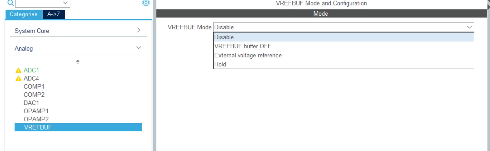

After the upgrade, this selection is no longer available and VREFBUF is set to ‘Disabled’ by default.

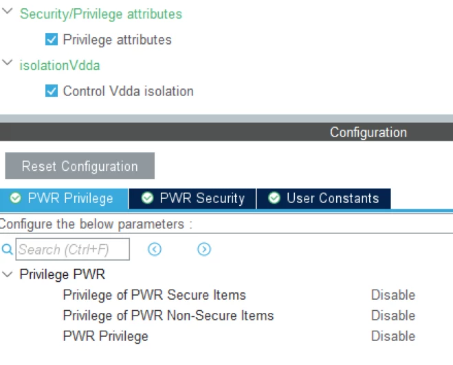

I have also noticed that since the upgrade there is the option ‘isolation Vdda’ under ‘PWR’, which cannot be deactivated.
Ultimately, this means that 0V is applied to the Vref pin and the ADC and DAC do not function correctly.

old Version:
new Version:

Internal voltage reference is missing from the VREFBUF mode. This issue was reported (under this internal ticket 199643). I suggest that you take a look at this Thread.

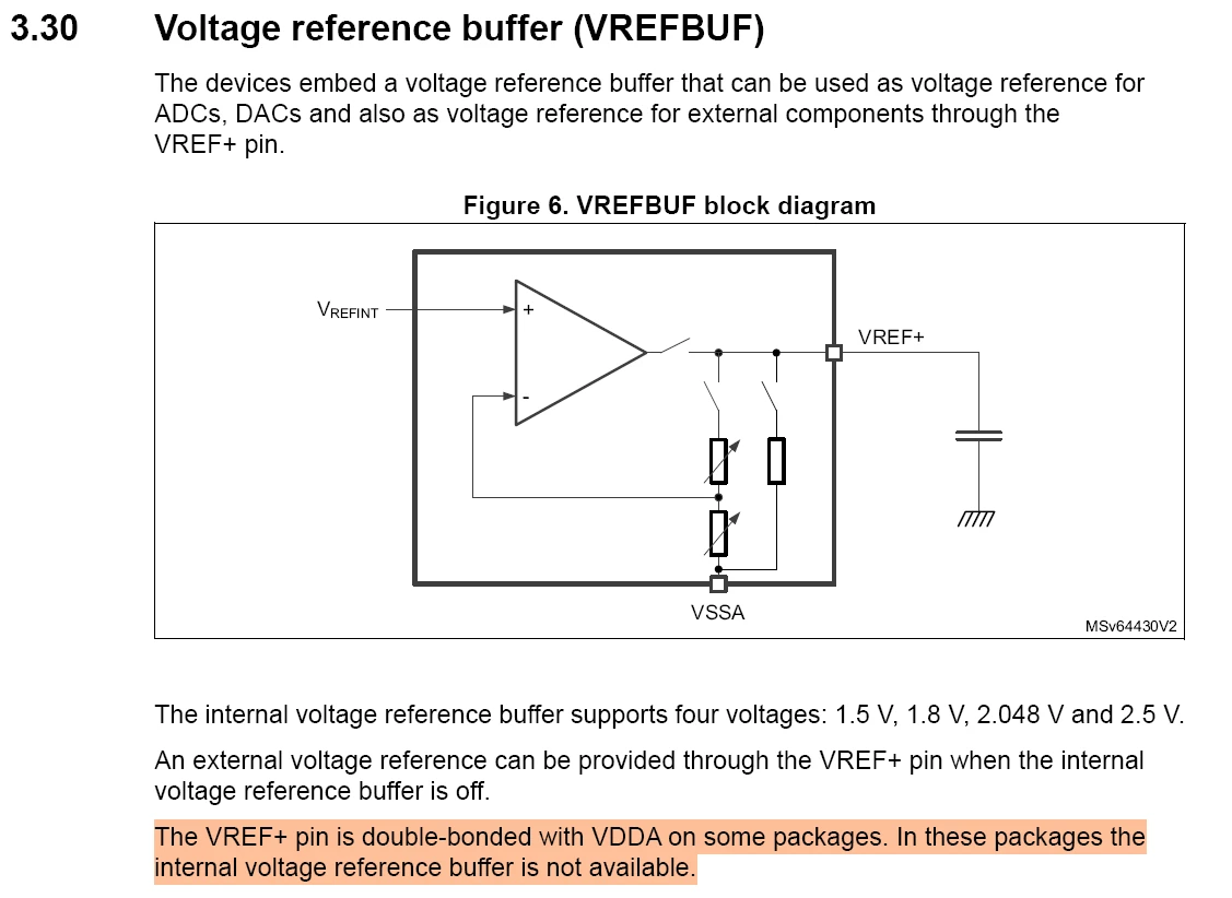

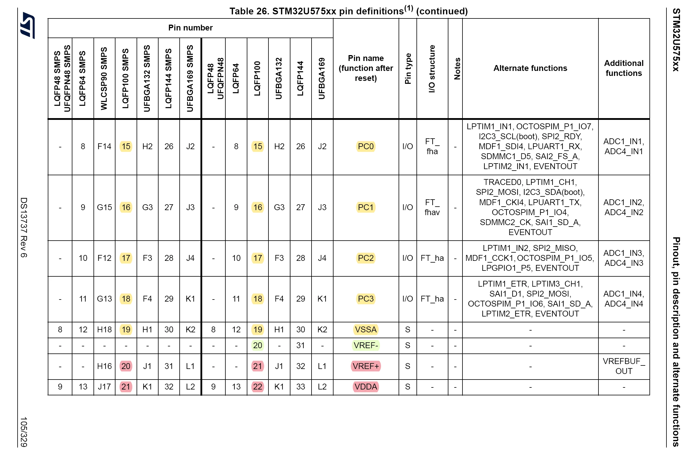

The reference manual states that VREF+ is not available for some packages and is double-bonded with VDDA.
However, the package I am using should not be affected by this (after all, it already worked with the old software version).
Could it be that there is a bug in the CubeMX software that it assumes that VREF and VDD are double-bonded in my package as well?
