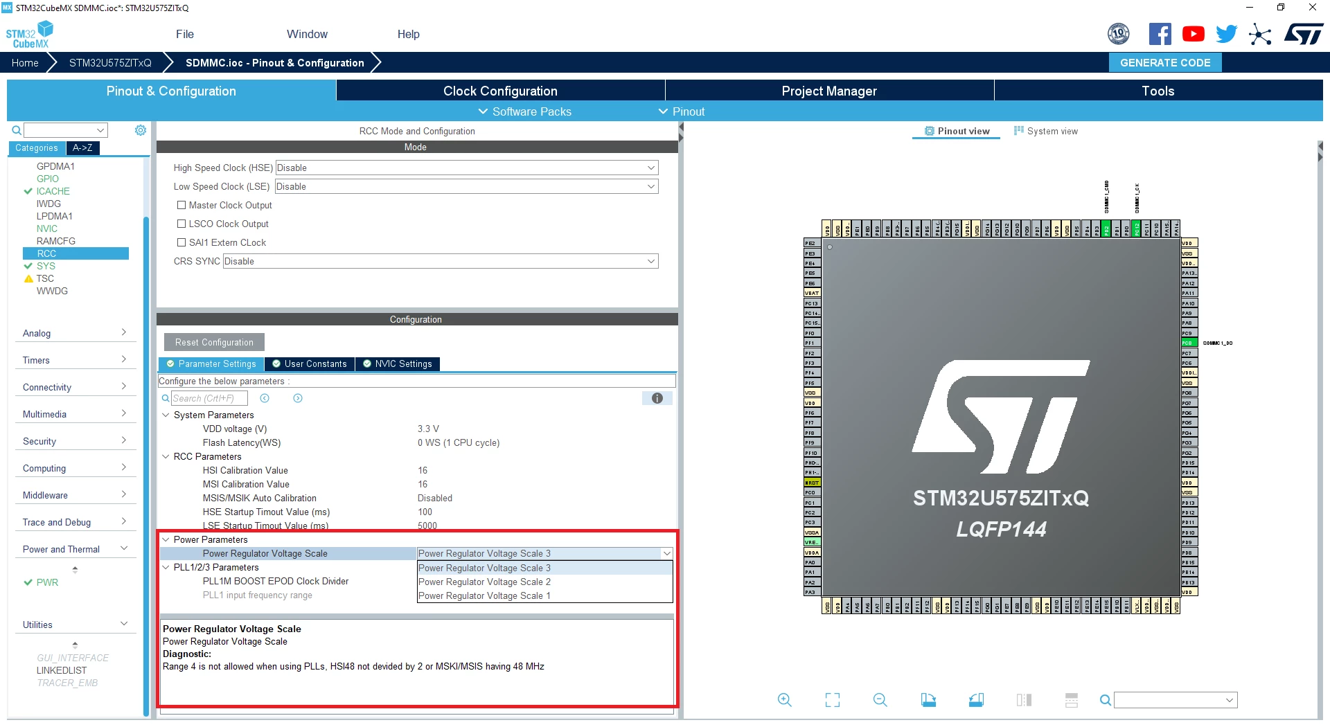

I'm building a project using Cube MX (LL drivers) for the STM32U575ZITxQ processor (has SMPS) and I would like to get the processor into LL_PWR_REGU_VOLTAGE_SCALE4. Setting the MSIS to 16MHz achieves this but when I add in the 4 bit SDMMC interface in Cube MX the auto generated code only sets the regulator voltage to LL_PWR_REGU_VOLTAGE_SCALE3. This results in higher power consumption.
I am aware of the clock limitations of the SDMMC vs AHB bus and have adjusted PLL1P (sources SDMMC clock) to 16 MHz.
If I manually change the code to set it to SCALE 4 every thing seems to work ok but I would rather not deviate from the auto generated Cube MX code. Is it possible to achieve voltage scale 4 with SDMMC?

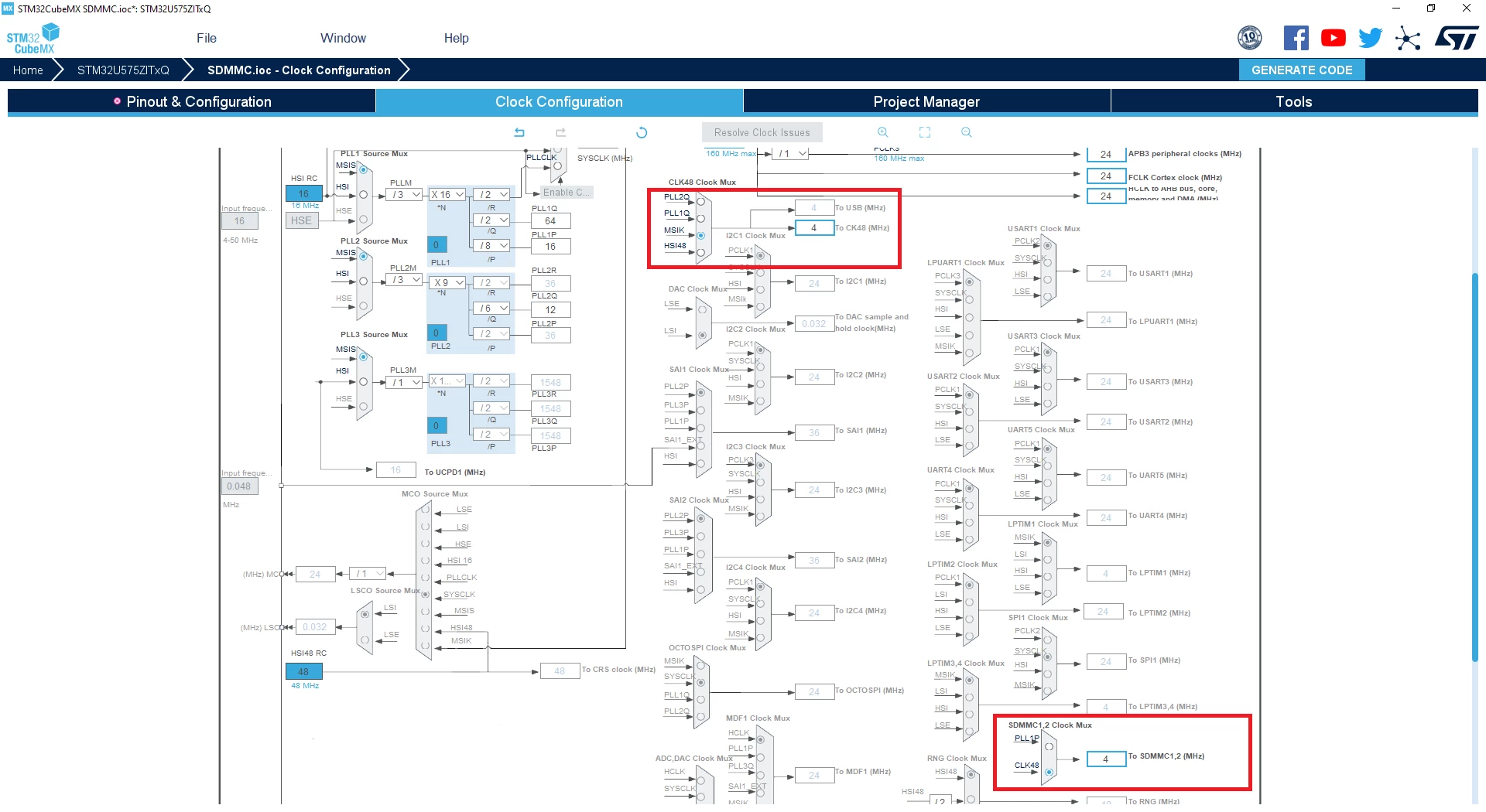

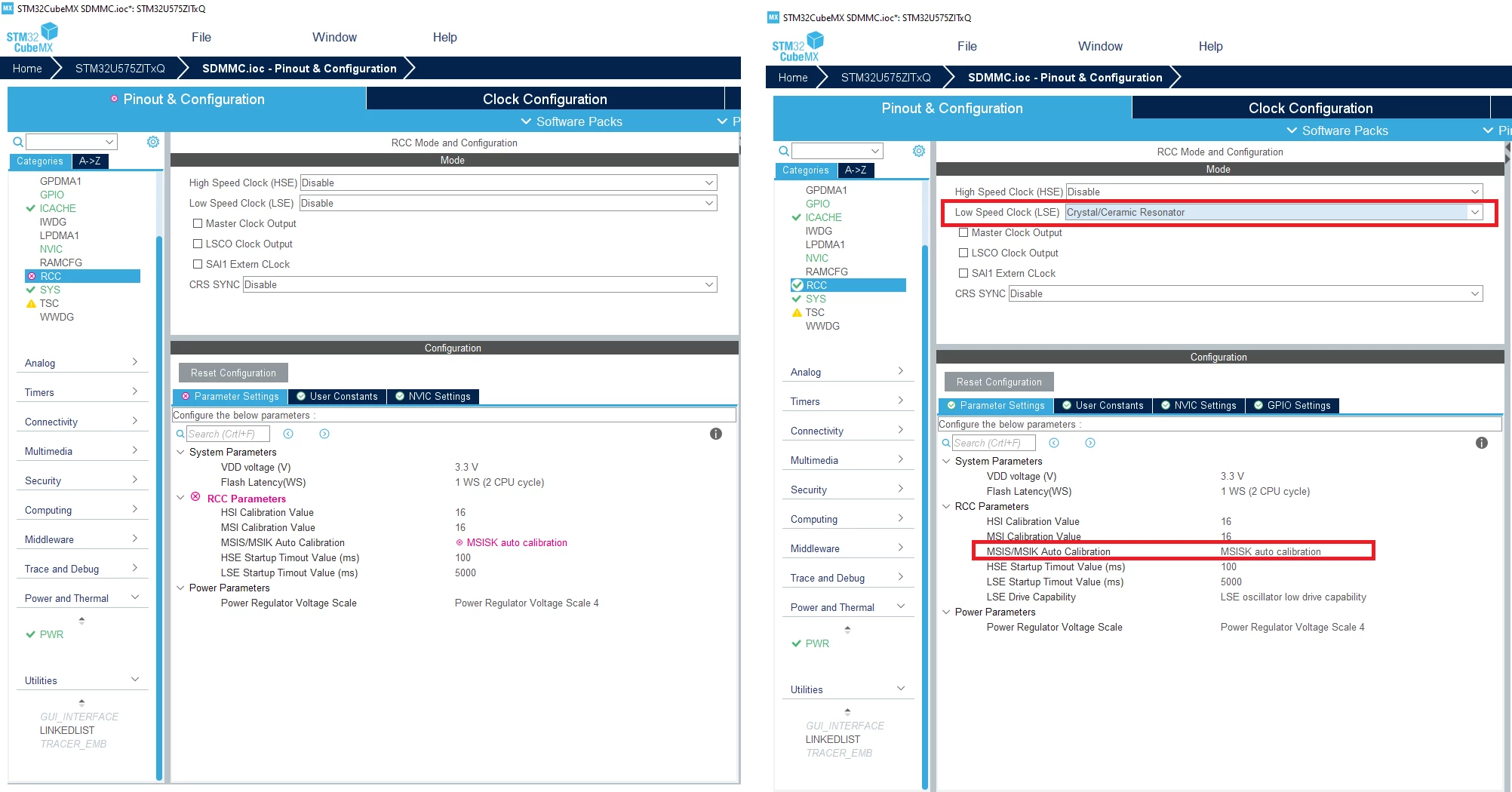

Actually this is a normal behavior, Range 4 is not allowed when using PLLs, HSI48 not divided by 2 or MSKI/MSIS having 48 MHz.
0693W00000JP8mYQAT.pngSDMMC uses either PLL1P or CLK48 as a source clock. In this case, Range 4 can be selected, when SDMMC uses CLK48 and CLK48 Clock Mux is set to MSIK.
0693W00000JP8kOQAT.png 0693W00000JP8nCQAT.pngPS: Adjust the frequencies according to your application and please make sure to enable LSE as it is required by the MSIK to calibrate itself.
I Hope this helps :)
