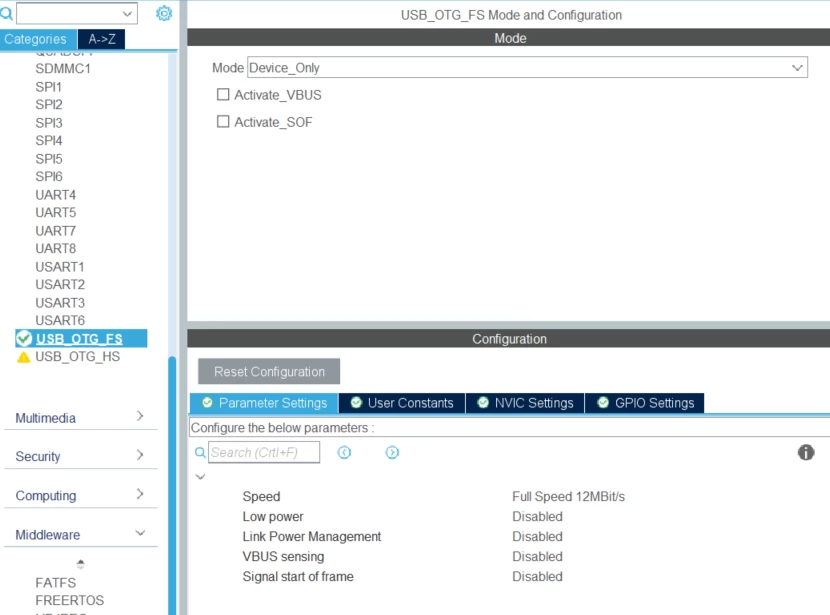

Virtual port COM on STM32F756ZG visible but OTG_FS_IRQHandler appear all the time. So I can't communicate with my computer. Why?
  • September 29, 2021
  • 5 replies
  • 2836 views

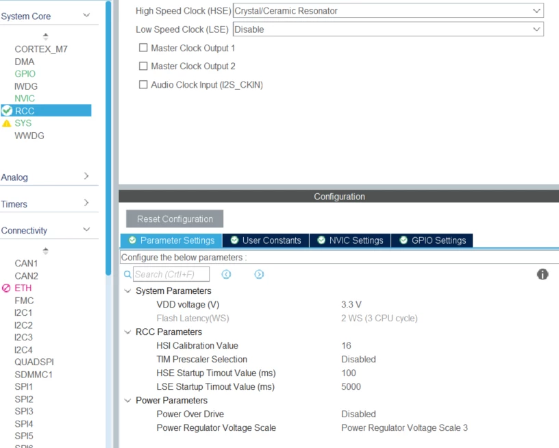

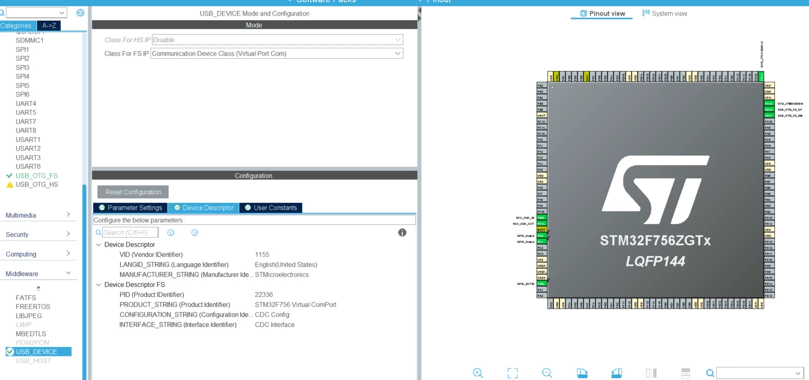

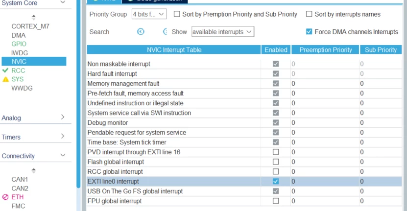

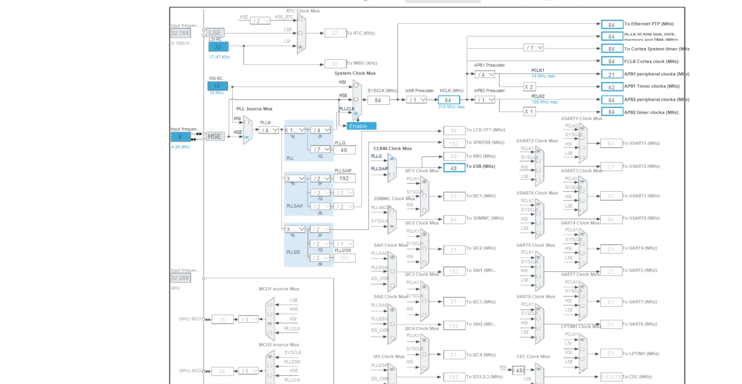

0693W00000FAlpfQAD.png0693W00000FAlpuQAD.png0693W00000FAlqTQAT.png0693W00000FAlsUQAT.png0693W00000FAlrlQAD.png0693W00000FAlrMQAT.pngI cannot communicate with my computer. I detect the port but in debug mode, I see that the OTG_FS_IRQHandler interrupt is triggered regulary when I send data on my computer.
I did the same thing with my dicsovery card F411, it works. But with nucleo F756, it doesn't work. I'll give you all the parameter I set in picture linked.
To complete, when I tried to open the COM port with python, I have this error :
serial.serialutil.SerialException: Cannot configure port, something went wrong. Original message: OSError(22, 'Paramètre incorrect.', None, 87)
Do you need more details?
Could you help me? I passed a lots of time on it and I don't find.
Thank you!

Mike_ST
September 29, 2021
The fact that OTG_FS_IRQHandler is called is a good sign.
You have an example of VCP implementation in the F7 software package, so you can compare what is missing:
STM32Cube_FW_F7_V1.16.0\Projects\STM32756G_EVAL\Applications\USB_Device\CDC_Standalone
available here :
https://www.st.com/en/embedded-software/stm32cubef7.html

FToub.1
FToub.1Author
September 29, 2021
In fact, my program work well. It works well on windows 7 but not on windows 10, but normally, we don't need driver?
Mike_ST
September 29, 2021
You don't need it, normally.
But driver is here:
https://www.st.com/en/development-tools/stsw-stm32102.html
