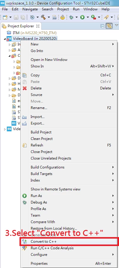

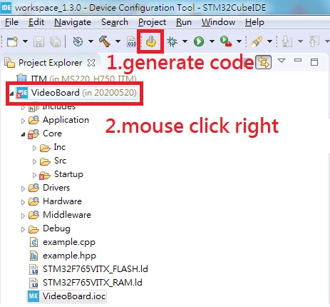

The setting steps is:
  1. Generate (or regenerate) code.
  2. Mouse click right on the project icon as: 0693W000001cgiFQAQ.png
  3. Select "Convert to C++" item as:0693W000001cgiKQAQ.png

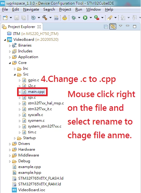

  4. Change main.c to main.cpp( from STM32CubeIDE rename). Don't rename from the Windows file system manually. If regenerate code need to rename again and maybe need to porting old main.cpp to new main.cpp(last rename) again. 0693W000001cgiPQAQ.png
  5. Build project.
