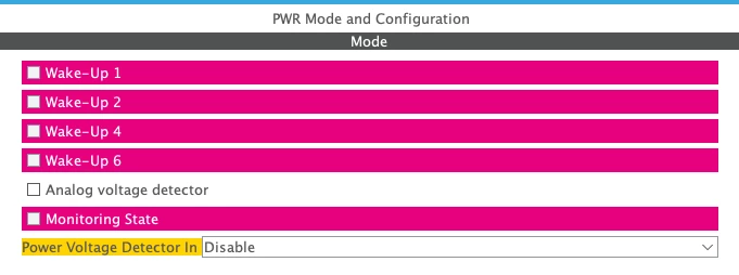

Using STM32CubeMX 6.3 how do you set power SMPS/LDO setting for a STM32H725?
Right now I am having to manually alter the code after each generate
0693W00000FDWQ7QAP.pngI would expect it here
But all I see is
What am I missing?
Many thanks,
Thomas

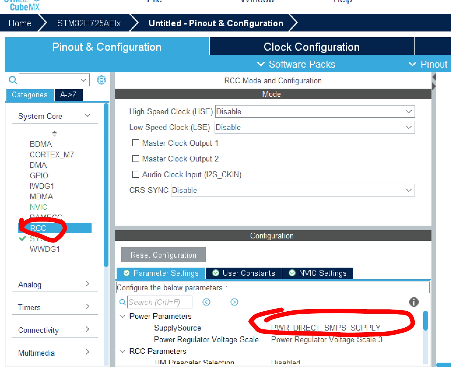

TDKBest answer
Oct 23, 2021 5:36 PM UTC
The power supply source setting is under "System Core" in the RCC tab.
1 reply
