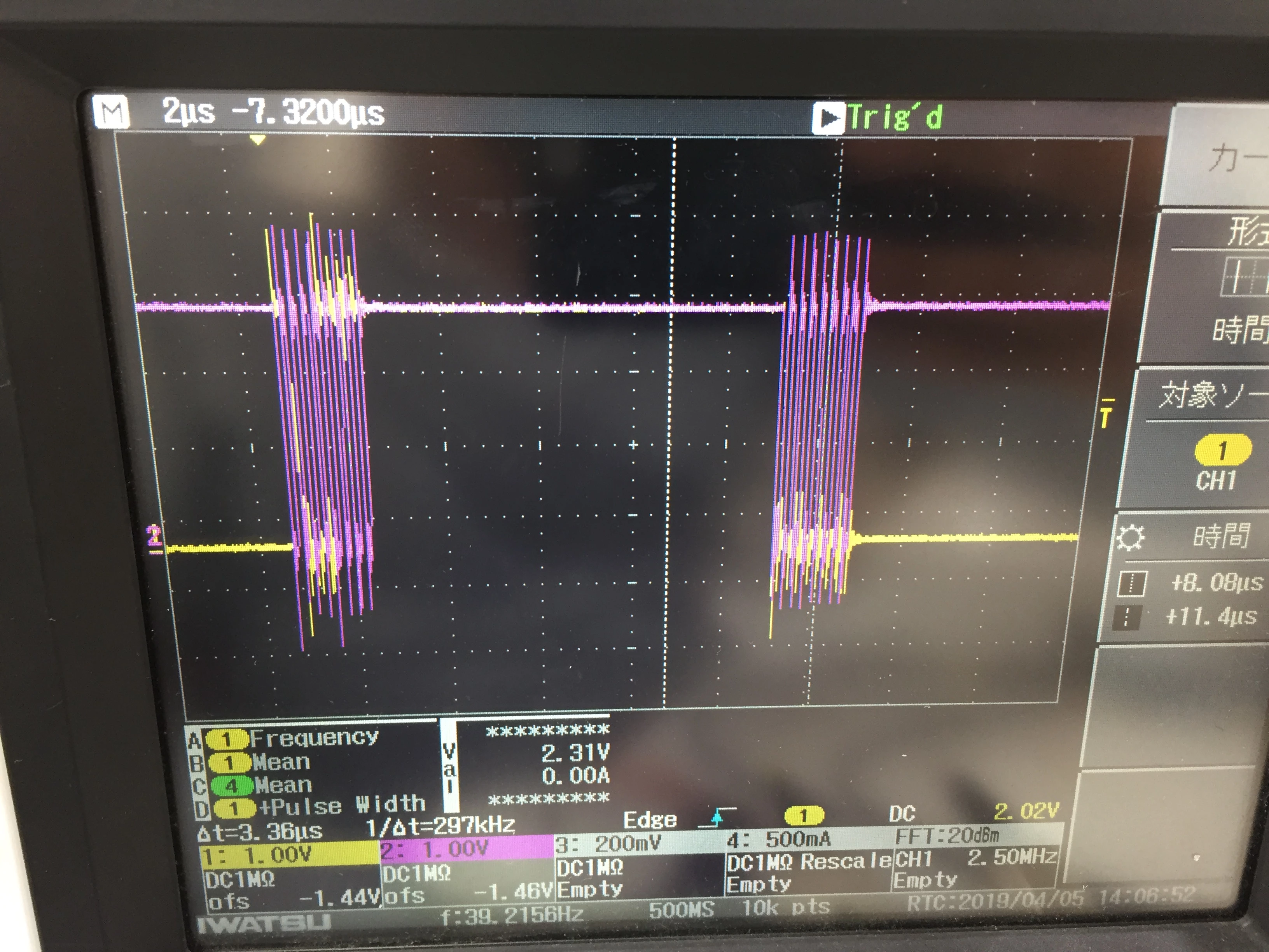

Hello Guys
I am asking you kindly your help.
I am trying to read register data from the LSM6DS3 IMU sensor from STM using SPI. I succeeded reading the value 0x69 from register WHO_AM_I using Arduino.
Now I am stuck when trying to do it with STM32 micro-controller.
Reading data sheet I concluded the following specs: Max SCLK 10MHz, 8 bits word, MSB first, CPOL high, CPAHSE 2 Edge (sampling on trailing edge).
I think I am setting the stm32 micro-controller like so but I am not able to read any data from register WHO_AM_I .
The following code is the reading process, followed by the SPI init routine.

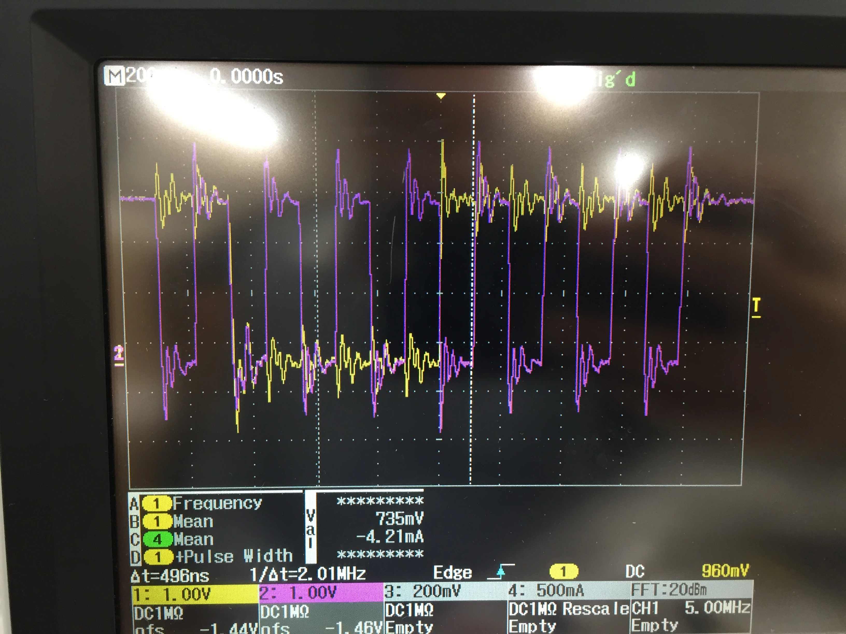

the problem is when I track the evolution of MOSI line and SCLK  by doing a transmit then receive, I am getting the reading in picture 1 using oscilloscope,
it look different than when I use the "HAL_SPI_TransmitReceive" as shown in picture 2.    in the case of  transmit then receive I can read 0x8F on oscilloscope but also an other byte 0x00 which I dont know where it is coming from. in case of "HAL_SPI_TransmitReceive" I can read 0x8F only.
In both ways I can read nothing on the MISO line

Best answer by Min-Kyoung Kim
Did you add this in your code (before while)?
__HAL_SPI_ENABLE(&SENSORS_SPI);
Even though I'm using 3 wire spi, I solved my problem by adding that code.
Also, I add my code. (I succeed!)

You should reset and set CS pin.

moha
mohaAuthor
April 5, 2019
@Min-Kyoung Kim​
Dear Kim
Thanks a lot I added this piece of code to my SPI_INIT function and now I am able to read the register correctly.
I did not do it at first because Transmit function checks whether the peripheral is enabled if not it will do it for you, this is handled by the HAL driver.
any idea on what caused for SPI not to be enabled ?
Min-Kyoung Kim
April 9, 2019
I don't know actually.
But, looking at the transmit function, ENABLE ​is executed last, before data is sent.
So I added ENABLE.
I fount this when I sent the data 2 times. First time, I failed. but second time i succeed. :)
