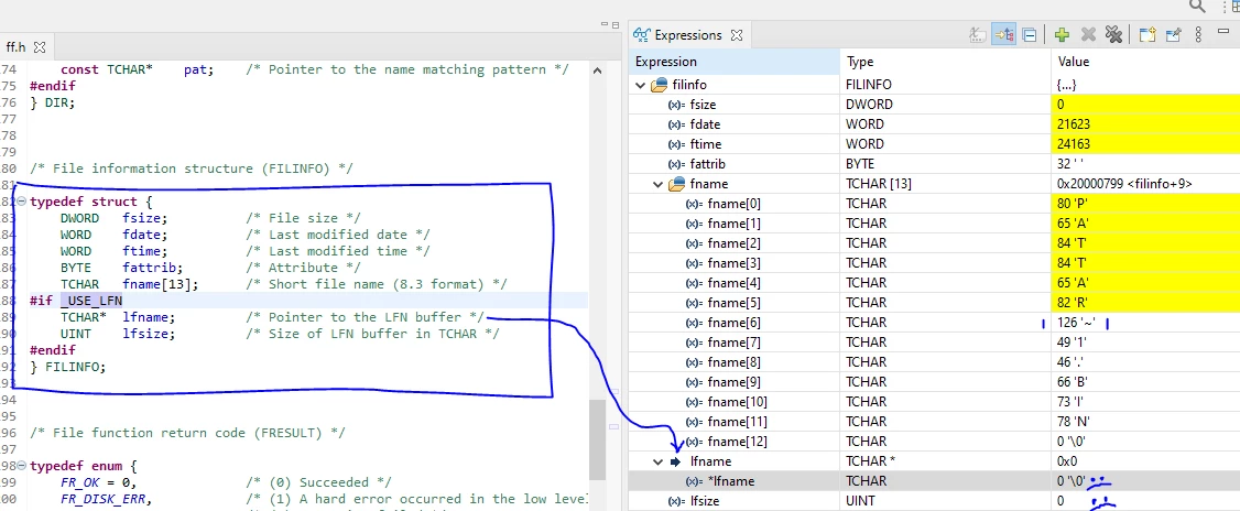

Using FatFs , i am unable to get long filenames, but i get the short filenames
I am able to read the fixed length fname.
But the pointer to the long filename is always 0.

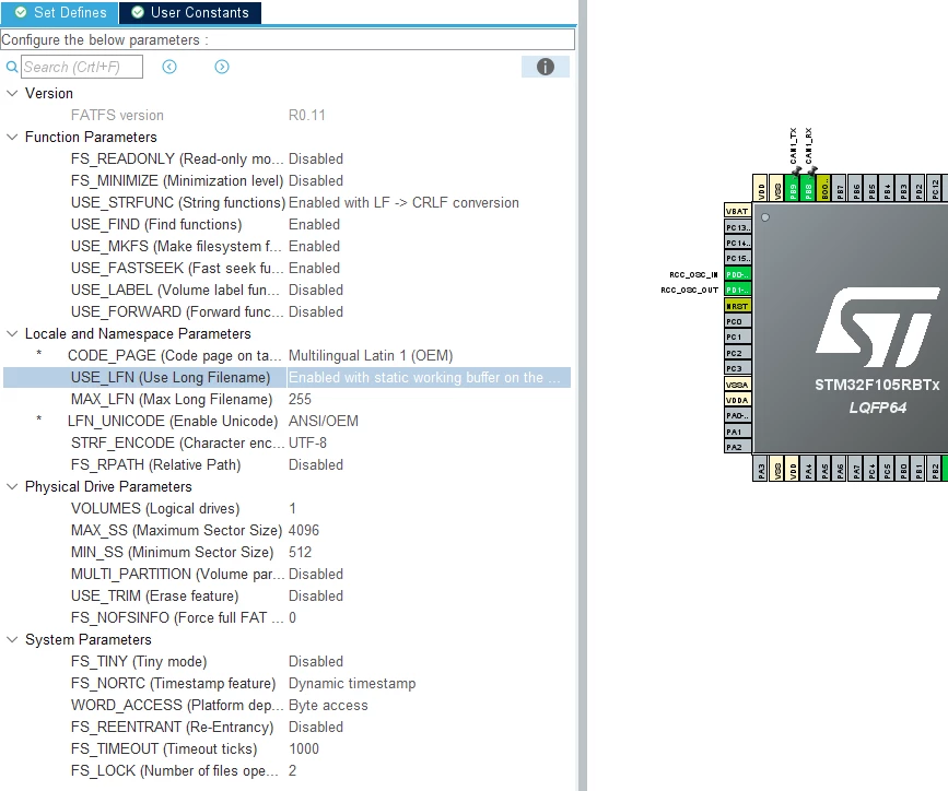

I tried the three different cubeMx options for long filenames :
  • static buffer on the BSS
  • dynamic buffer on heap
  • dynamic buffer on stack
None of them works.
My setup:
  • stm32f105RBt6 custom board.
  • SD Card trough SPI2, sandisk ultra 16GB.
  • CubeMx version 6.4.0, STM32Cube_FW_F1_V1.8.4 package which uses FatFs version R0.10c, Nov 09, 2014.
  • CubeIDE Version: 1.8.0

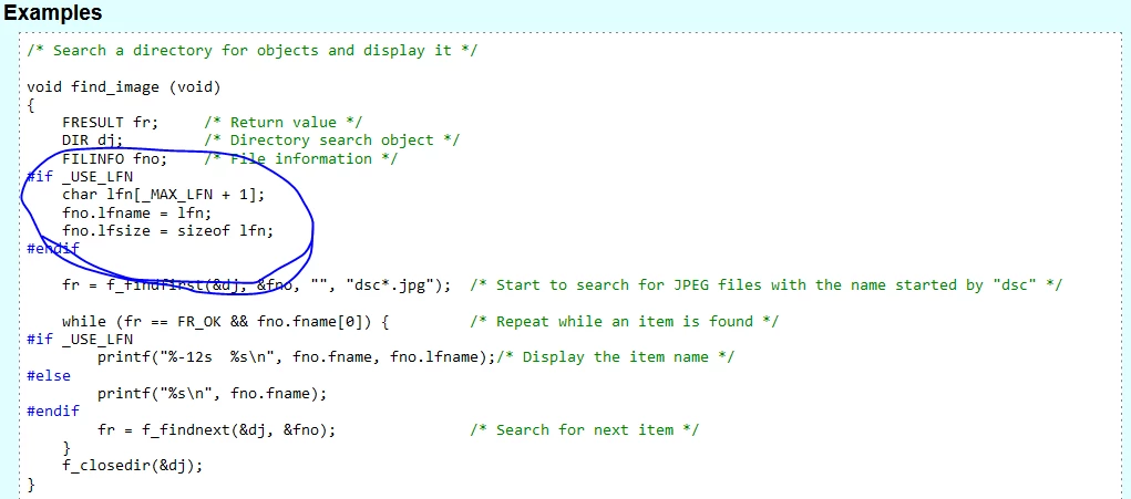

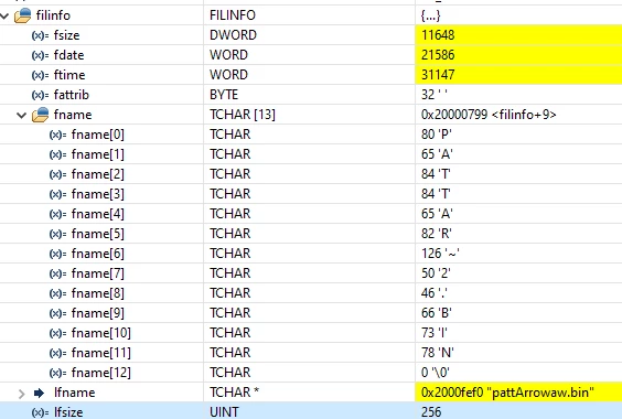

Okay that wasnt so hard, i just needed to find up to date documentation.
(C:\Users\**your user**\STM32Cube\Repository\STM32Cube_FW_F1_V1.8.4\Middlewares\Third_Party\FatFs\doc)
Apparently the pointer needs to be initialiced by you first.
adding this three lines fixes the code:
