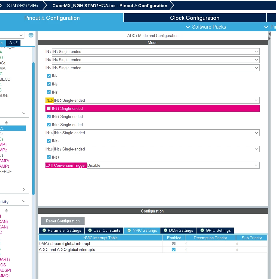

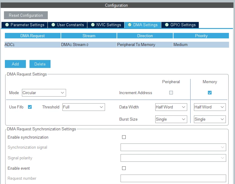

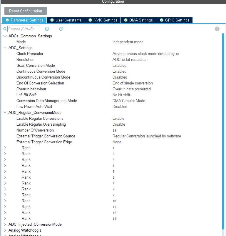

Using ADC with DMA on H7 causes DMA transfer error
I am trying to use circular DMA to transfer data from ADC1 into a buffer using CubeMX-generated code to configure the ADC and DMA. The DMA stream encounters a transfer error on transferring the first item.
The device is an STM32H743.
Using a debugger it can be seen that the program excute HAL_ADC_ConvCpltCallback()
and right after it gets to HAL_ADC_ErrorCallback()
Atatched are captures of the CubeMX configurations.

DMA was initialized after ADC and I2C...
After fixing the initilazation order the problem was solved.
