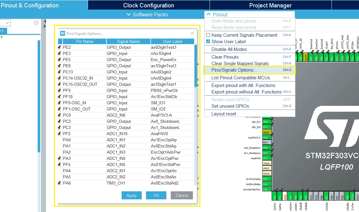

user label problem in cubeMx 6.1.0
After an update from cubeMX 6.0.1 to 6.1.0 the user labels have disappeared in pinOut view. Only the function per pin is displayed. Is there an option to make either the user label or the pin function visible?

Khouloud OTHMAN
Nov 27, 2020 11:23 AM UTC
Hi Arnold Bischof,
It is a bit odd, but I still can't reproduce the problem. I have loaded the attached project and when the warning window is displayed offering two options; whether to Migrate or continue, I have tried both cases and it is always the same result: There is no problem with the User Labels, they're correctly displayed in the Pinout view.
Checking the Pins/Signals Option, the User Label field is specifying the label name for each pin of the list as set by you.
0693W000005CsiQQAS.pngIt is strange that it is not working from your side, but let's see what can we do to resolve this misbehavior.
So if you miss any information in the scenario that you have reproduced please let me know, is there any other warning messages appearing when you load your project?
Also attaching the STM32CubeMX.log file that you'll find under [C:\<User_path>\.stm32cubemx] will be helpful to further check the problem.
I will be waiting for your response.
Khouloud.
Arnold Bischof
Nov 27, 2020 9:11 PM UTC
Hello Kouloud,
I found out what the problem was.
After loading the 6.0.1 IOC file for the first time in cubeMx 6.1.0 the Pin User Labels were not displayed initially, although the 'Show User Label' entry in the 'Pinout' menu was checked. After unckecking and checking the 'Show User Label' entry once, the user labels are now displayed correctly.
Khouloud OTHMAN
Nov 30, 2020 4:50 PM UTC
Hi Arnold Bischof,
Thanks for your feedback, glad that you have found a solution for your problem.
Actually this happens just in case the Show User Label entry has been unchecked when you have saved the project before migration: In the project created with older version of CubeMX (the 6.0.1 in this case), the Show User Label entry is unchecked. Loading the saved project with the latest 6.1.0 CubeMX version, this entry will be checked by default.
This behavior may be confusing, I will report it internally to find a permanent solution and I will keep you posted.
