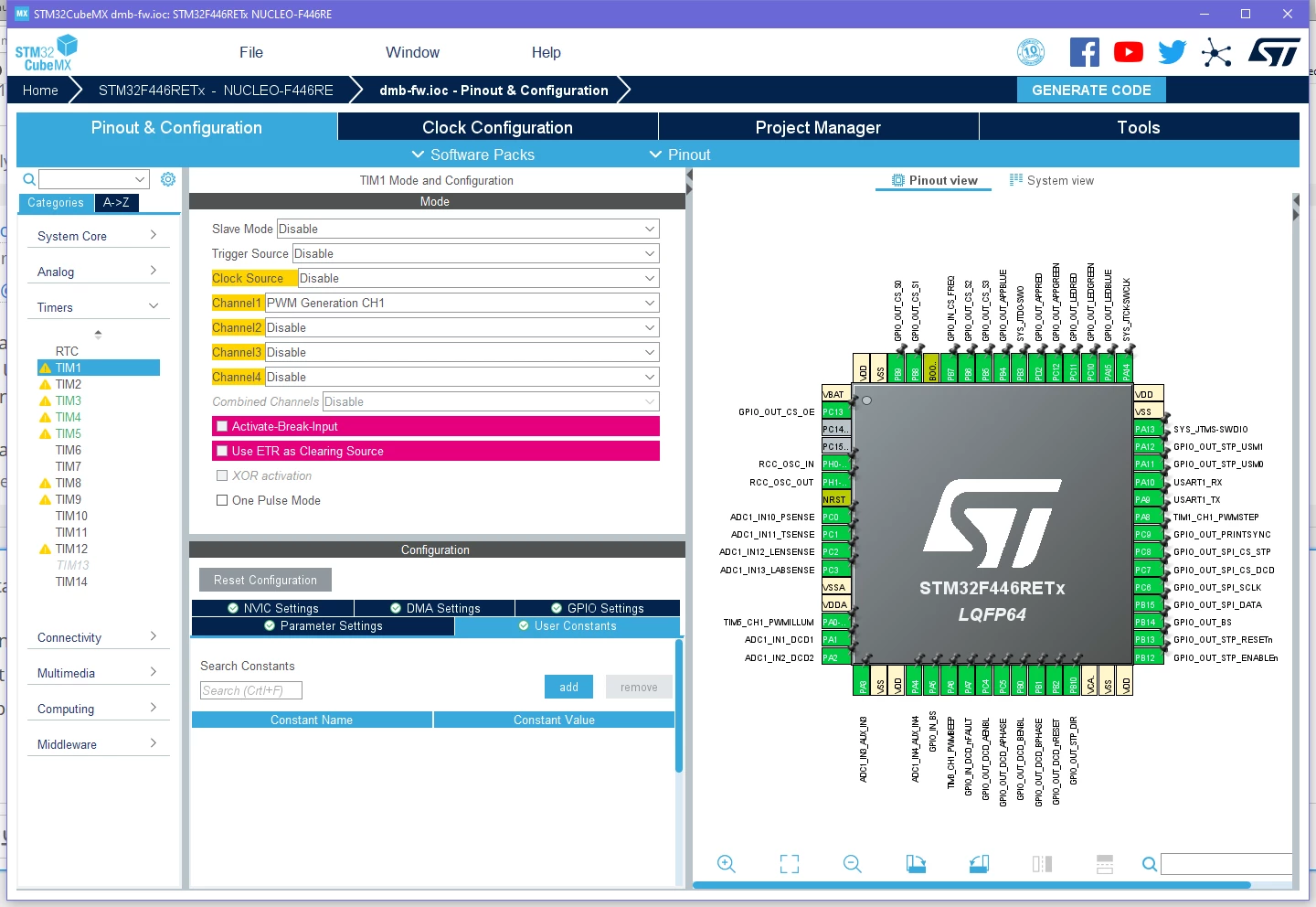

User Constants disappear from Device Configuration Tool (timers configuration panel) if the .ioc file is closed and reopened in the same session.
version: 1.5.1
MCU: STM32F446RETx

Adriano Melis
Jan 20, 2021 9:28 AM UTC
Hi Kholoud,
Here it is.
When the .ioc is opened the first time in the Eclipse session the user constants are available, however, if the .ioc is closed then reopened are not available anymore.
The code generation however "sees" them: in this project the generated code uses the constants used in the DCTool in the timers init functions.
Cheers,
Adriano

Adriano Melis
Jan 20, 2021 10:19 AM UTC
Hi Khouloud,
With MX standalone the problem persists.
Steps:
  • open the attached .ioc -> constants OK
  • start a new project, choose MCU
  • reopen original .ioc -> constants not visible, see screenshot:
0693W000007By64QAC.pngCheers,
Adriano
Khouloud ZEMMELI
Khouloud ZEMMELIBest answer
Jan 20, 2021 10:47 AM UTC
Hi @Adriano Melis​
Yes, now issue reproduced (thanks for sharing steps, the problem appears at this level: start a new project, choose MCU, without saving the project).
Issue will be fixed, thanks for your contribution.
Khouloud
Adriano Melis
Jan 20, 2021 10:55 AM UTC
Keep in mind that the problem exists in the IDE version without changing project: maybe a step is missed when closing the .ioc project tab in Eclipse, then reopening it.
Thanks for the speedy answers :)
