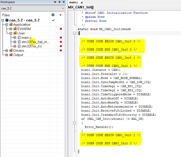

Auto-genned code in v1.14 had USER CODE blocks in MX_CAN1_Init, but after upgrading to v1.15 they are no longer there.
Where should I put my ConfigFilter and ActivateNotification calls now?

​Issue will be fixed in the next release @Community member​ .
For the moment you can uncheck  the " Genearte peripheral initialization as a pair of ".c/.h" files per peripheral " under Project Manager-code Generator, you can find under main the MX_Can_Init function with the user code section ( this is a provisional solution for your case).

​Hello @Community member​
could you please share your ioc file ?

Khouloud ZEMMELI
June 4, 2019
​Using F7 with V1.15 firmware package version (I think this's your case) - there's no problem ! no difference between V1.14 and V1.15  concerning CAN User code section.
-CubeMX 5.2.1-
Best Regards,
Khouloud.

Here's my .ioc file and I'm locked to v5.1.0 of CubeMX unless there is good reason to update our team.
I tried updating CubeMX and no luck.
