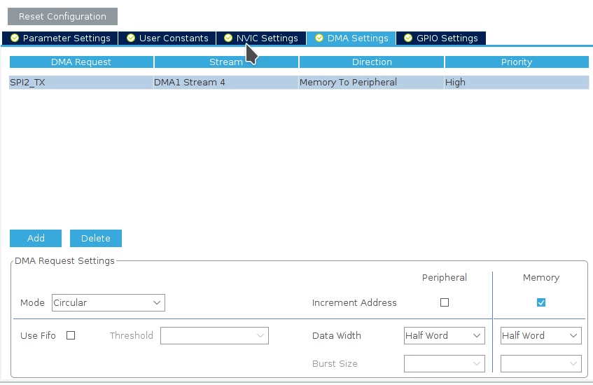

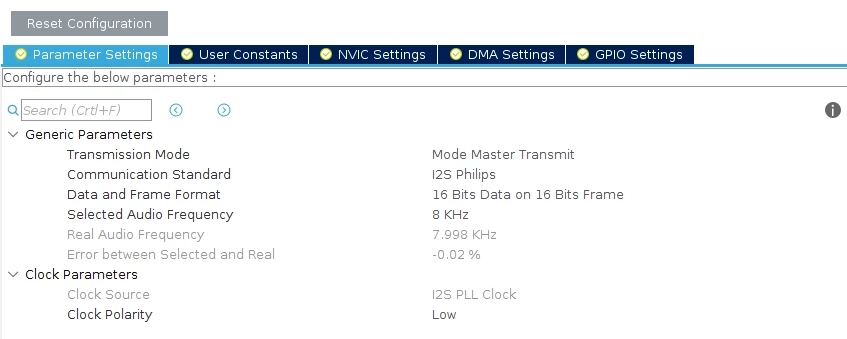

I want to send audiodata from STM32f401 MCU to PCM5102A audio codec through I2S interface. Here are my settings in CubeMX:
Code I used is:

When I use beep_blocking() function - everything is ok and I hear small peace of noise. But when I use beep_dma() function - nothing happens. What I am doing wrong?
P.S. I do not want to use this as "beep" actually, I want to send data continuously. This is just a test.

waclawek.jan
November 28, 2019
I2S is not intended to be used intermittently; the idea is, that clocks and data are there continuously. Some I2S chips expect that and upon seeing intermittent clock, they stop working or work in an unexpected way.
Observe the I2S pins using oscilloscope and/or LA.
