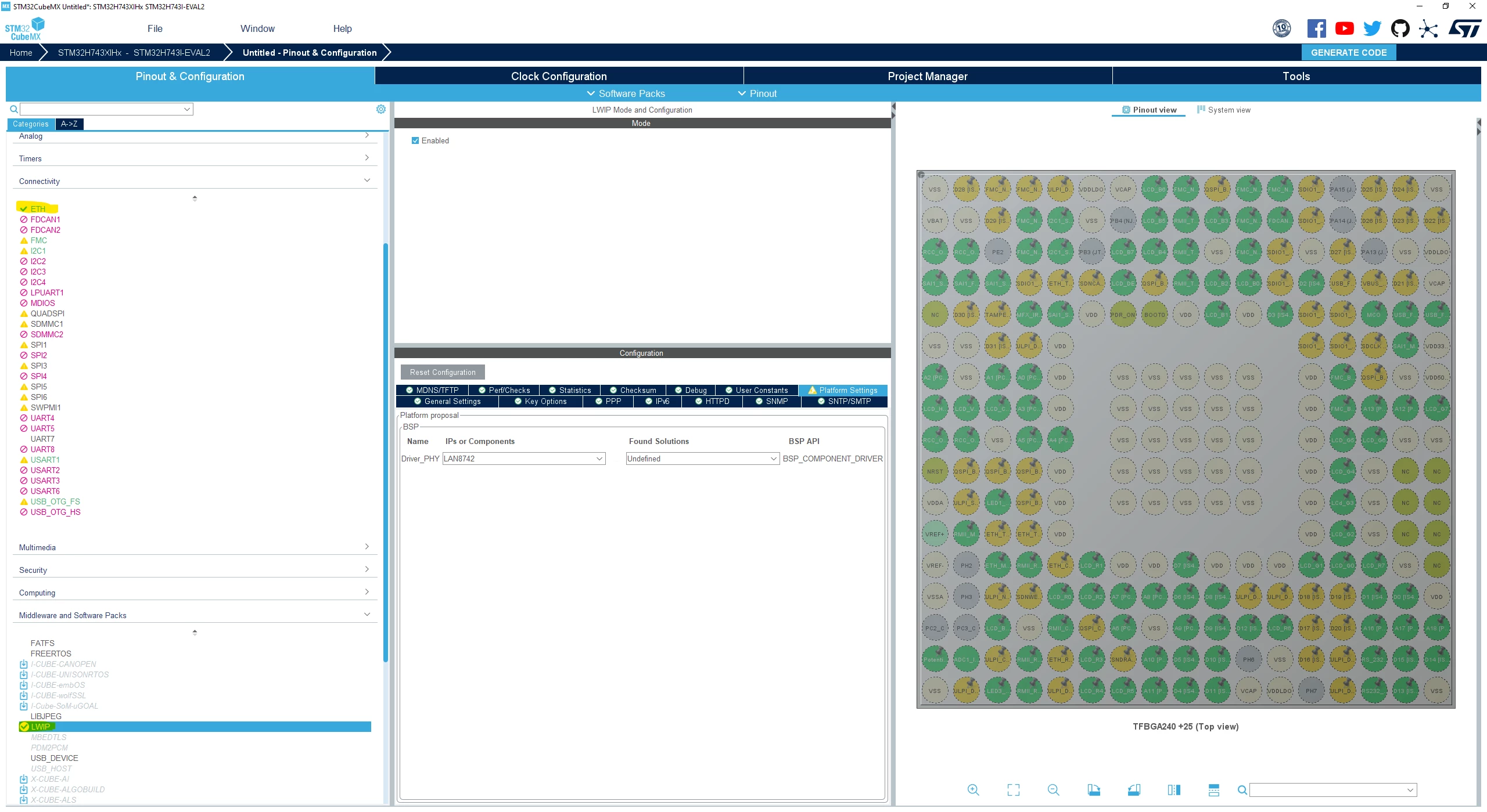

Use H743I Eval 2 board able to build application with TouchGFX to display data. I am trying to activate ETH with lwip middleware with CubeIDE. have enable CORTEX_M7 (I,Dcache) but cant select any mode in ETH, (forbidden mark) as result, lwip is diabl

Ghofrane GSOURI
March 10, 2023
Hello @ET.2​
In order to activate the LWIP you need to first activate ETH which is partly disabled in the H743I Eval 2 board project
As shown in the following screenshot, I was able to activate ETH after solving all the conflicts
0693W00000aIgrgQAC.pngPlease check the attached ioc.
Thanks
Ghofrane
