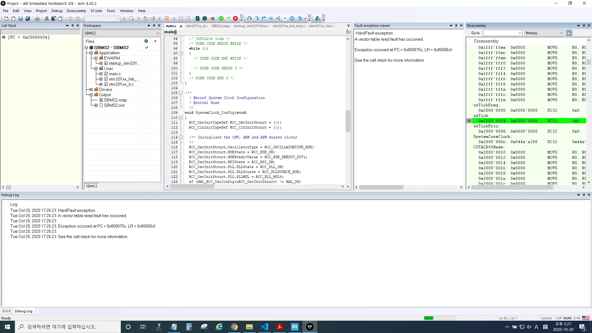

Use CubeMX STM32F103 Hard Fault exception??
Hello
i'm using stm32f103rct.
Use cubemx and just set RCC,and SYS(JTAG, Timebase Systick)
compile with IAR and then download and debug press break.
Hard fault exception
0693W000004KMPxQAO.pnghelp plz

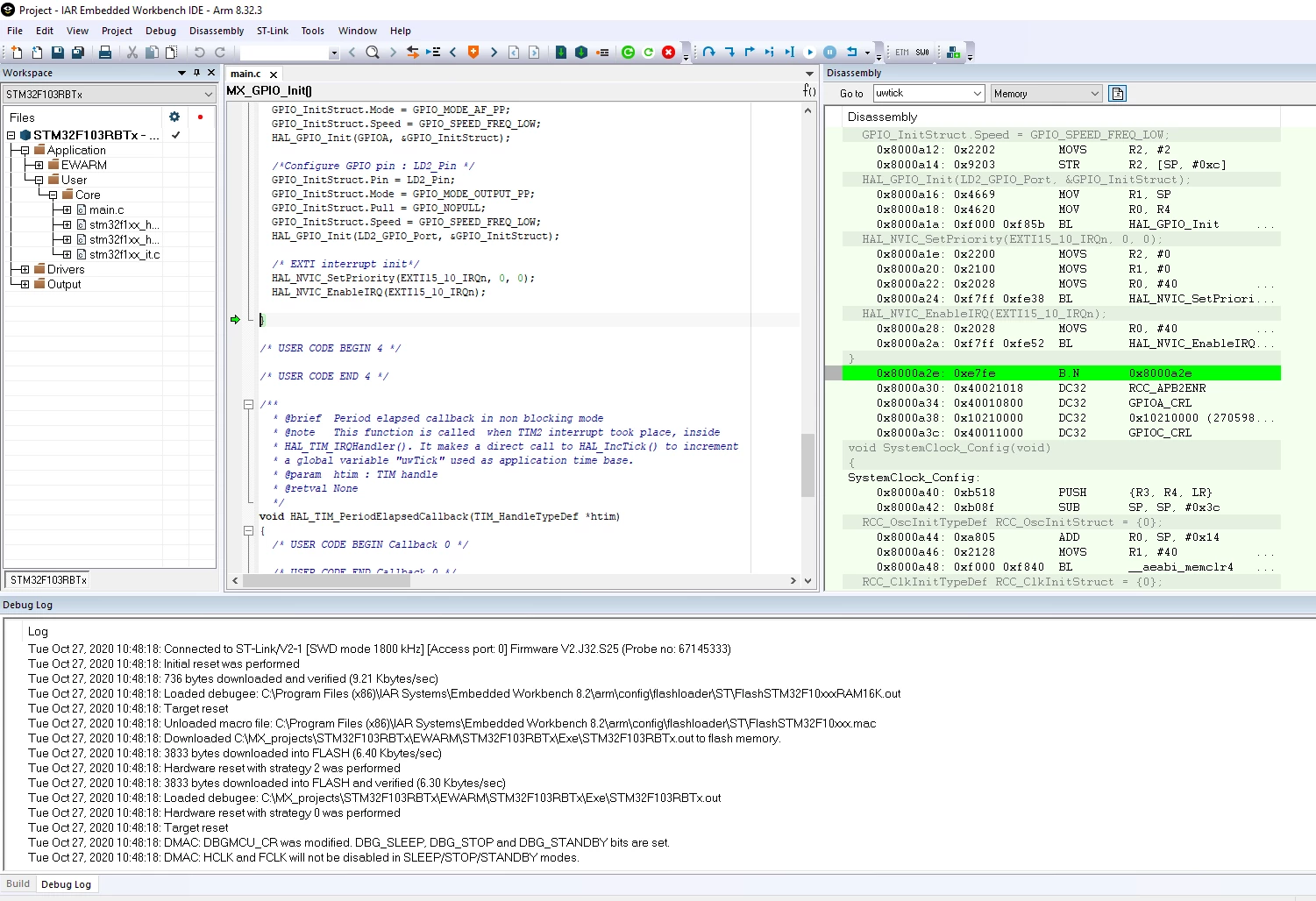

Hi @sjaey.1​
Tested the same scenario by using a Nucleo-F103RB, i had no issue.
0693W0000059R2HQAU.pngBest regards,
Nesrine

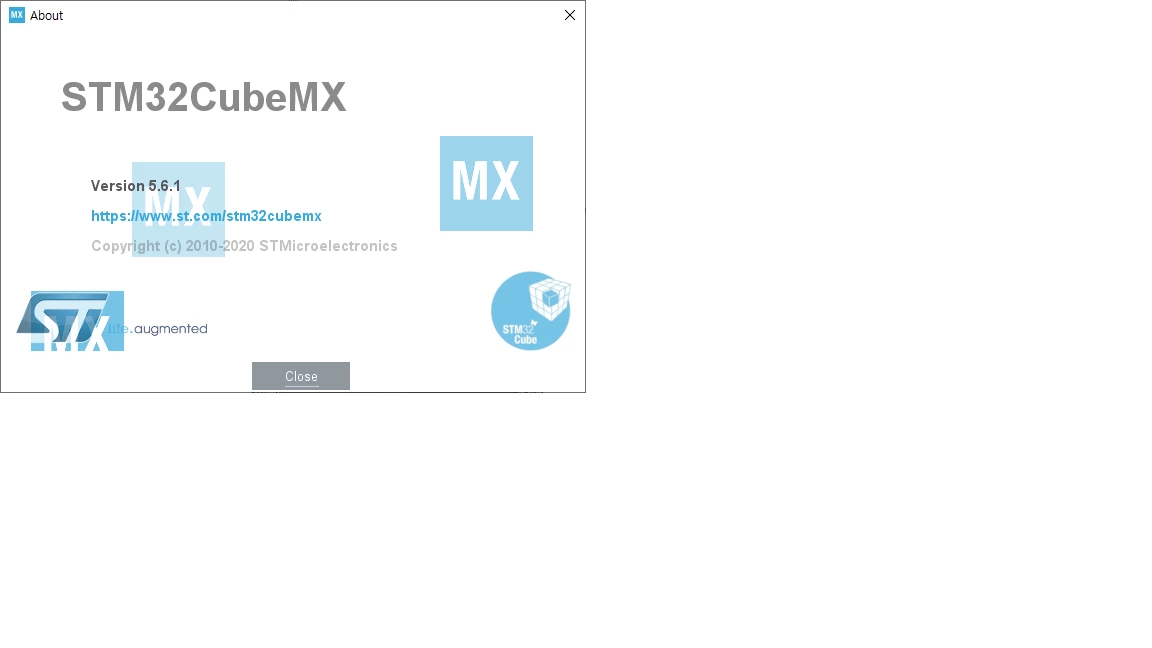

Could you please share you .ioc file to check with.
Please specify you STM32CubeMX version.
sjaey.1
sjaey.1Author
Oct 27, 2020 10:08 AM UTC
0693W0000059RCHQA2.pngVersion 5.6.1

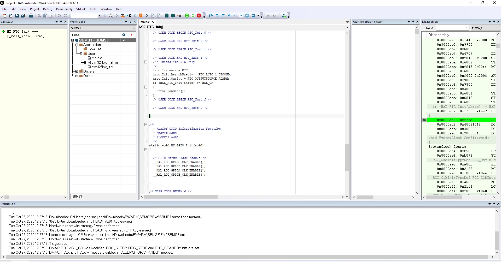

Nesrine.JLASSI
Visitor II
Oct 27, 2020 12:30 PM UTC
No issue detected when using STM32CubeMX v 6.0.1.
