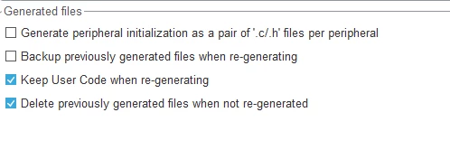

Hello ​@RAltm
Can you ensure that the option “Keep User Code when re-generating” is checked in Code Generator section:
Otherwise, could you please provide your IOC file in order to investigate the issue?
BR, Souhaib

Hello  Souhaib,
the option to keep user code is enabled in my .ioc file. Currently I’m trying to setup a minimal working example. Unfortunately I’m not able to reproduce the issue, neither on the MWE nor on my project.
Since there’s no out-of-the-box working CDC non-RTOS example for my device (STM32U083) I’ve to implement it piece by piece based on snippets found on the web. So there’s a chance that I accidentally put a snippet before a USER CODE BEGIN statement and then regenerated the source code.
The only other thing which comes to my mind right now is that my changes to the .ioc file triggered a full replacement of the files.
I hope I can reproduce the issue, but I’ve to investigate first.
