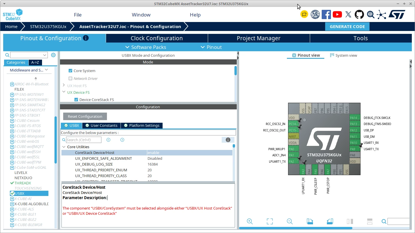

USBX CoreStack Device/Host warning in STM32CubeMX
OK, thank you it is so easy to omit.
Could you please help me with another issue on usbx: Default value for “CoreStack Device/Host” is “enable” but there is warning in red: The component “USBX/CoreSystem” must be selected alongside either “USBX/UX Host CoreStack” or “USBX/UX Device CoreStack”
Core Sytem is selected as you can see. Or is it referencing to some other component?

    Hello @MZina.1
    Thanks for your comment.
    As I see your configuration is ok and since the purpose of this warning is to advice customers to set the right configuration. So, once done, this message should not be necessary.
    I raised this behavior to development team for more investigation via this internal ticket number 0065125.
    Best regards,
    Aimen
