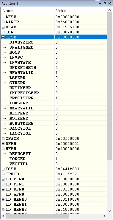

Stack corruption possible.  Dont know the source.  Have already increased "Minimum Stack Size" at CubeMX->Project Manager->Project to 0x4000.  Should be plenty.  Or are you referring to the stack size of the DefaultTask, which we increased to .stack_size = 512 * 4?
The hard fault is happening at the first line of uxListRemove( ListItem_t * const pxItemToRemove ) in list.c
List_t * const pxList = pxItemToRemove->pxContainer;
Registers look like:
exception description:
   The processor has escalated a configurable-priority exception to HardFault.
  A precise data access error has occurred (CFSR.PRECISERR, BFAR) at data address 0xc8d0245c.
   Exception occured at PC = 0x800a26a, LR = 0x8007c47
Hope this helps.

At the faulting line, does pxItemToRemove and pxItemToRemove->pxContainer contain valid values? If not, set a hardware watchpoint and rerun the program to figure out where they get modified.

According to the fault analysis, it seems you are reading from a bad address 0xc8d0245c (invalid pointer being passed to the function). So, this may not be solved by just increasing stack size but also check state of your pointers: pxContainer in the initialization.
