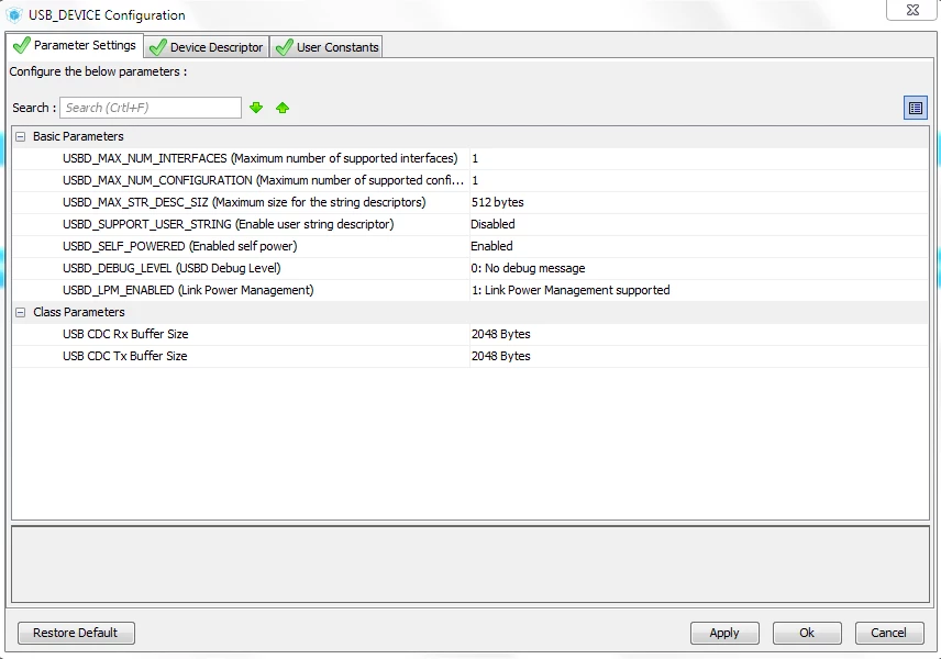

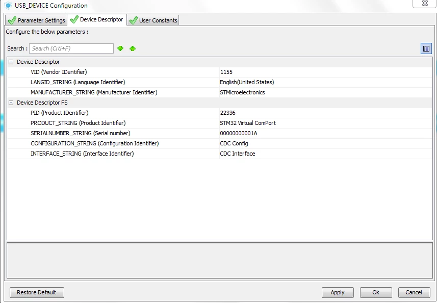

In the PC app, I work with the STM32F722RETx LQFP64 micro-controller
In WIN7 it always works. At WIN10 does not work.
After I turn off and turn on the card, the board data that the system sees (both win7 and win10) is:
Status for device COM2              :
   Baud:           1899758337
   Parity:         None
   Data Bits:      242
   Stop Bits:      1
   Timeout:        OFF
   XON/XOFF:       OFF
   CTS handshaking: OFF
   DSR handshaking: OFF
   DSR sensitivity: OFF
   DTR circuit:    OFF
   RTS circuit:    ON
At win10 it doesn't work
On win7 the board works after my app on win7, where I set the COM parameters
the system starts to work (on both win7 and win10):
   Baud:           9600
   Parity:         None
   Data Bits:      8
   Stop Bits:      1
   Timeout:        ON
   XON/XOFF:       OFF
   DTR circuit:    OFF
   RTS circuit:    ON
I move the board (which is still ON) to win10 and it works
After the shutdown, it stops working at win10 again
It seems that the data is stored on the board only until the board is ON
0690X00000ARF5HQAX.png0690X00000ARF5CQAX.png0690X00000ARF57QAH.png0690X00000ARF4xQAH.png
Please help us to solve the problem

Jan 13, 2020 2:44 PM UTC
answer for every one having the same problem:
in file usb_cdc_if.c add the following USBD_CDC_LineCodingTypeDef
USBD_CDC_LineCodingTypeDef LineCoding =
		115200, /* baud rate*/
		0x00, /* stop bits-1*/
		0x00, /* parity - none*/
		0x08 /* nb. of bits 8*/
In function CDC_Control_FS/ CDC_Control_HS
add to these two cases the code bellow:
case CDC_SET_LINE_CODING:
 	LineCoding.bitrate = (uint32_t)(pbuf[0] | (pbuf[1] << 8) | \
 	 (pbuf[2] << 16) | (pbuf[3] << 24));
 	LineCoding.format = pbuf[4];
 	LineCoding.paritytype = pbuf[5];
 	LineCoding.datatype = pbuf[6];
 break;
 case CDC_GET_LINE_CODING:
 	pbuf[0] = (uint8_t)(LineCoding.bitrate);
 	pbuf[1] = (uint8_t)(LineCoding.bitrate >> 8);
 	pbuf[2] = (uint8_t)(LineCoding.bitrate >> 16);
 	pbuf[3] = (uint8_t)(LineCoding.bitrate >> 24);
 	pbuf[4] = LineCoding.format;
 	pbuf[5] = LineCoding.paritytype;
 	pbuf[6] = LineCoding.datatype;
 break;
