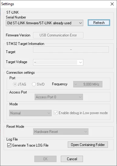

BKrag.211
Visitor II
October 18, 2019
I'm sorry to hear that.
Personally I had the issue on a Nucleo-F411RE board, where the issue was solved following these steps.
Before solving it, the STM32 ST-LINK Utility showed this in the settings window after pressing the refresh button.
