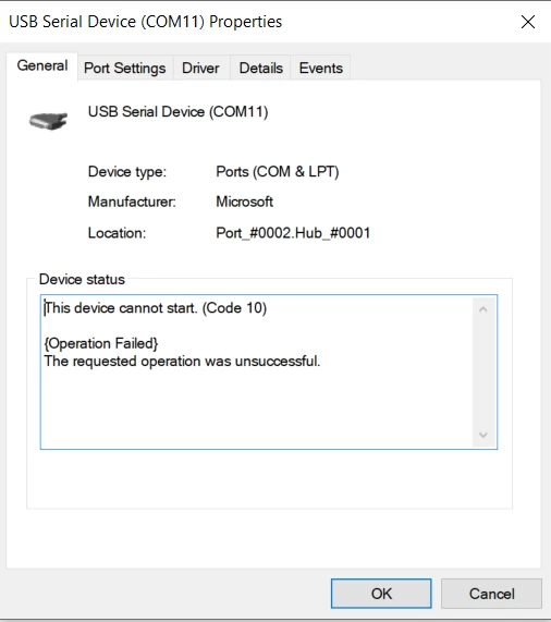

USB CDC on STM32H745 M4 Core is not working.

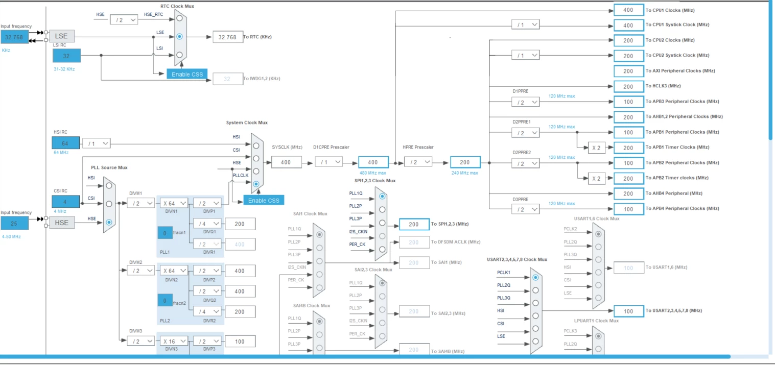

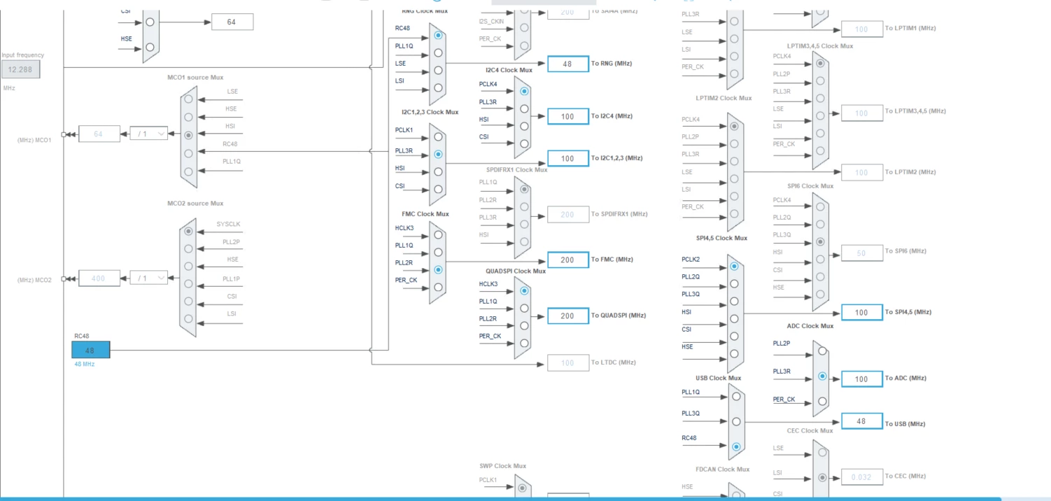

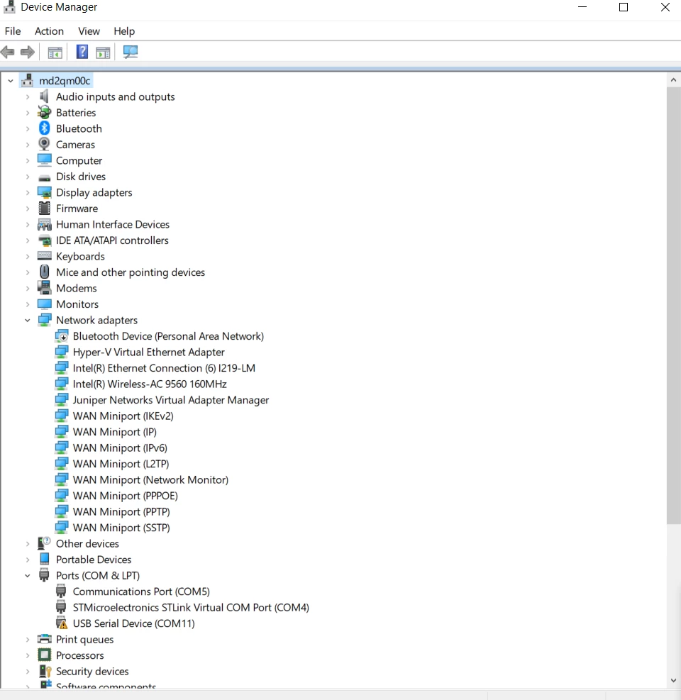

0693W00000Y8QsaQAF.png0693W00000Y8QsGQAV.png0693W00000Y8Qs6QAF.png0693W00000Y8Qs1QAF.pngI am trying following:
1) USB CDC on M4 core
Clock configuration attached

Results are attached.

Pavel A.
January 17, 2023
The code10 device ​cannot start is not because of descriptors. Requests for descriptors, strings etc likely were successful.
