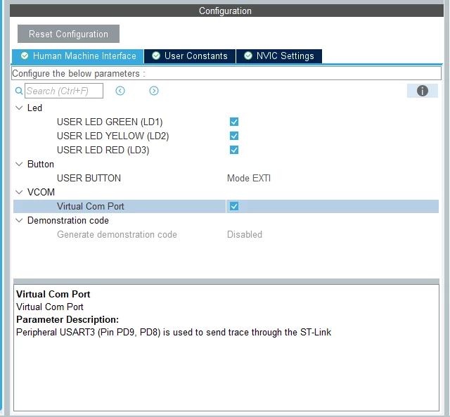

I'm working on a dual-core project (Cortex-M7 + M4) for the NUCLEO-H755ZI-Q board in CubeMX/CubeIDE.
I created the project using Board Selector (searched "NUCLEO-H755ZI-Q", selected the board, accepted the default LED/Button/Virtual Com Port options popup). Despite this, USART3's Mode dropdown is stuck on "Disable" and greyed out/unselectable in the peripheral configuration panel.
Pins PD8/PD9 initially showed as "under BSP control". I right-clicked on PD8/PD9 in the pinout view and manually assigned them as USART3_TX and USART3_RX. The pins now show these labels correctly on the diagram — but the USART3 Mode dropdown is still stuck on "Disable" and I still cannot select Asynchronous mode, set baud rate, or configure anything.

Hello ​@dinesh_ee_bme_72
You should uncheck Virtual com Port in BSP configuration to complete your configuration with USART3;
KR, Souhaib

Aug 6, 2026 12:11 PM UTC
it worked  Thanks
