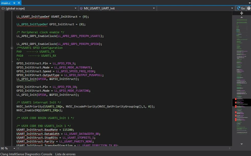

Hello
I m using STM32CubeMX 5.1.0 with STM32CubeF1 Firmware V1.7.0 09-October-2018
I try to generate the LL for use USART1 and USART2 over STM32F103RCT6, when the Cube generated the code I have the follow problems
 LL_USART_InitTypeDef (undeclared identifier)
 LL_GPIO_InitTypeDef (unknow type name)
GPIO_InitStruct.OutputType ====> OutputType no member named
USART_InitStruct.BaudRate ====>Undeclared identifier

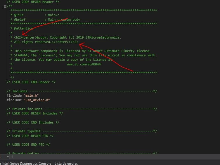

I m include 2 screenshot the first show the error message and the second is a little error in creationof the header
any idea how fix this issue???

Usually have to explicit include all the files you need, grep for definitions and prototypes. Does not pull from a single file like HAL libraries. ​

Sorry, OK, here I m attached all folder
thanks
Sebastian1
March 5, 2019
My problem is the same of (https://bit.ly/2C56WG9) please check it because they are report from December 14, 2017, thanks
