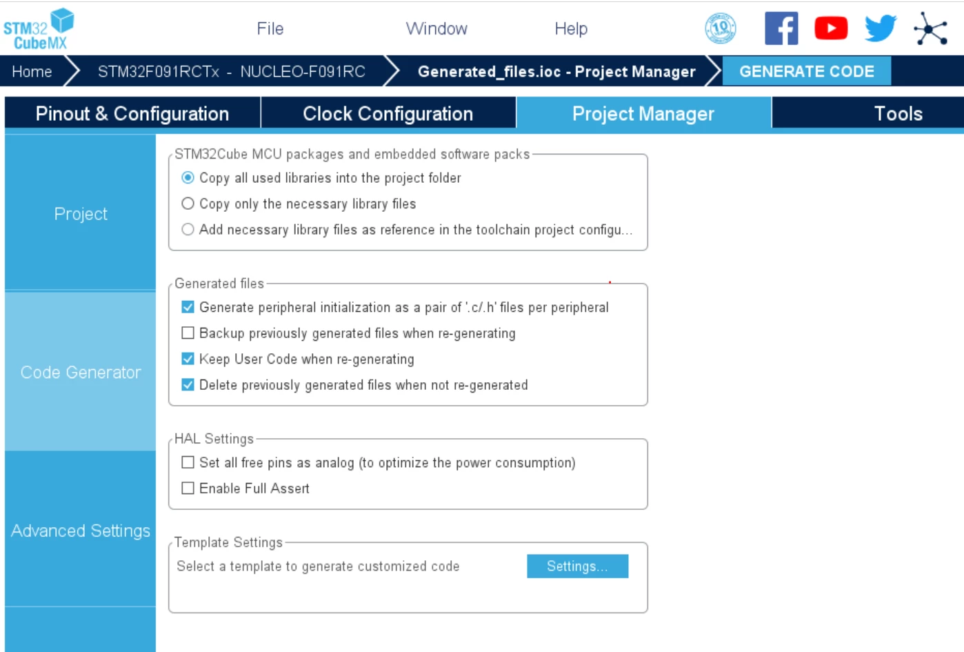

I am using a Nucleo F091RC.
When I create a new project, the
.../Inc/usart.h
.../Src/usart.c
.../Inc/gpio.h
.../Src/gpio.c
files are missing.
The button on the board is declared as GPIO_Input
The LED on the board is declared as GPIO_Output
PA2 is declared as USART2_TX
PA3 is declared as USART2_TX
When will the files appear in the folders?
Best answer by Khouloud OTHMAN
Hello FLamb.2,
STM32CubeMX tool offers you the possibility to whether generate the peripheral initialization in separate .c/.h files or keep all peripheral initialization in the main.c file. In fact you can check "Generate peripheral initialization as a pair of .c/.h files per peripheral" option under Project Manager/Advanced Settings panel as showed in the attached screenshot.

Hello FLamb.2,
Hope this answers your question.
If yes, please click on the Select as Best button on my reply . This will help other members of the community find this solution more quickly.
