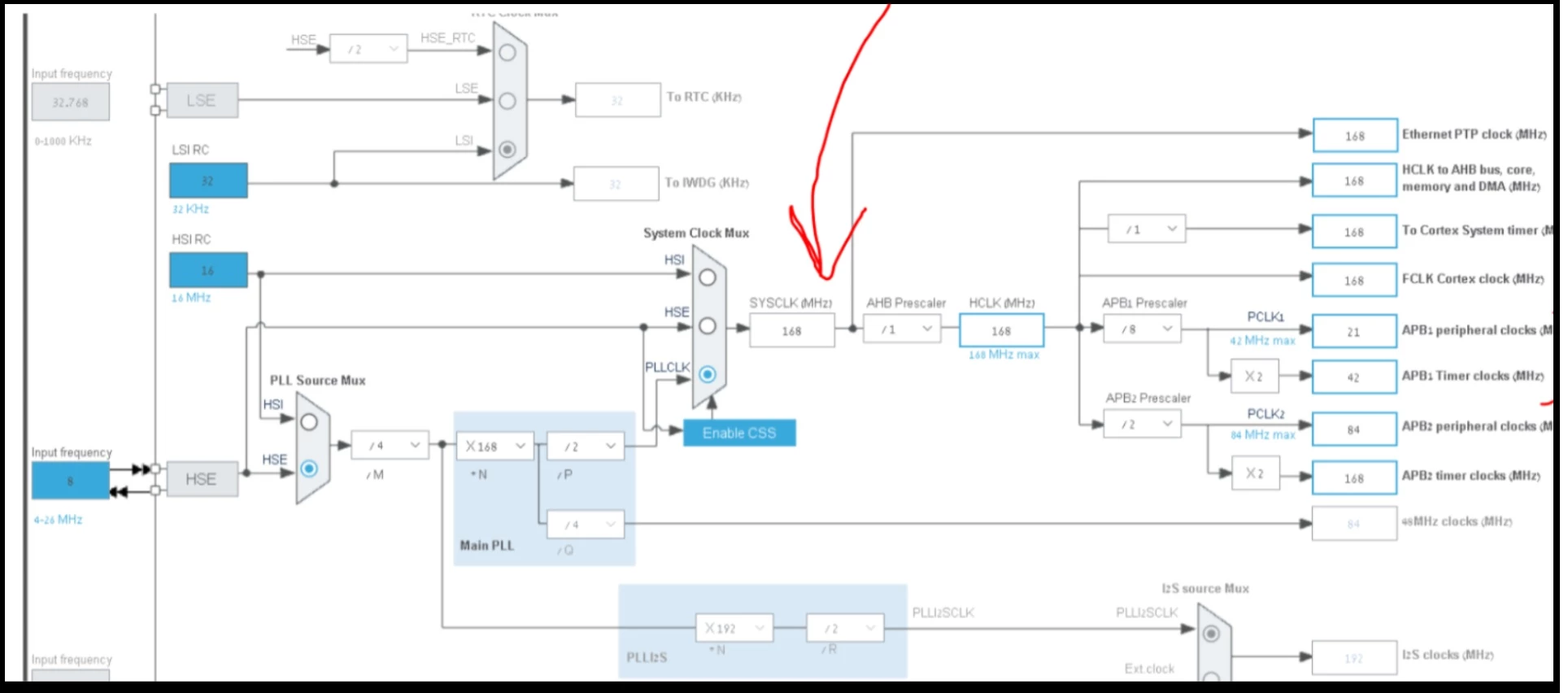

Hello,You are absolutly correct i get stuck in the while loop of delay'and i dont know why
In my delay block the clock is defined as shown in the cubemx APB1 clock is 21MHZ so i putt ARR=21 to make an interrupt every 1MHz,Why its a problem?
i added the toggle line and my HOME scope gave me a result as shon bellow.
Its not very accurate,but we see 1Mhz clock signal.
So the Irqhandler works great.
in the delay finction Myticks increasing evey 1microsecond is comparing myticks to us value in a while loop.
