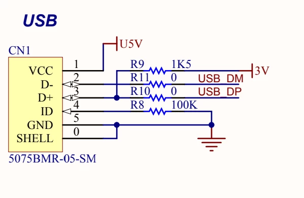

I'm trying to communicate in USB between my PC (host) and a stm32f429ZI board (device).
The size of the heap shouldn't be an issue as it seem like the memory allocation for the header is static. But I still tried to increase it to 0x2000.
I also tried to change the PC and the stm32f429zi board. No success.
Here are the schematics for the USB pins of this board.
I measured:
VCC 5.1V
D- 0V
D+ 2.9V
ID 0V
GND 0V

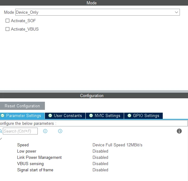

I tried to activate the VBUS as well even if my power source is from the PC and that I get the 5V on VCC, no improvement

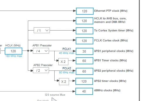

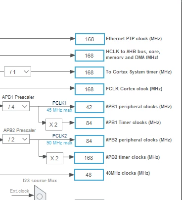

My STMcube settings and clock:
0693W00000QM3CDQA1.png0693W00000QM3CcQAL.pngUsb device is activated and set to Communication device class

I changed the clock ouput to this and it works now. Really feels ****. I don't know how I could have known.
_legacyfs_online_stmicro_images_0693W00000QM4Bf.pngThanks for the help anyway man, you would have probed the signal with a logic analyzer?

So some clocks too slow? There's perhaps notes in RM to avoid clock inversion and expectations. The PLL needs to be running for sure, along with solid 48 MHz. Things like SDIO have clock ratio expectations and PLL requirements, for sure.
