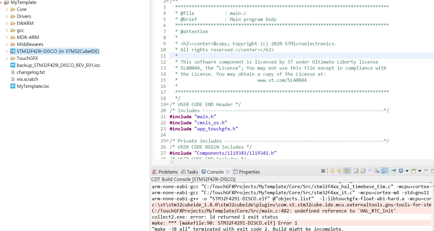

Hi, I want to use the RTC. ( Use STM32F429ZI Discovery board )

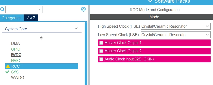

So, I set
1. RCC-> High Speed Clock Cystal/Ceramic Resonator
RCC-> Low Speed Clock Cystal/Ceramic Resonator

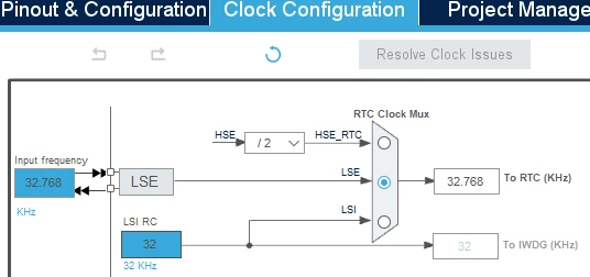

0693W00000JMfiJQAT.png2. Clock Configuration -> RTC Clock Mux -> LSE

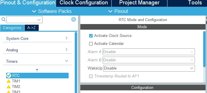

0693W00000JMfjbQAD.png3. Pinout & Configuration -> Timers -> RTC -> Active Clock Source
0693W00000JMfiLQAT.png4. Generate Code and Build project but, failed
Can you help me to solve this problem?

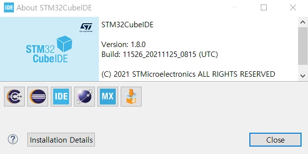

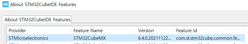

  3. I generate code, STM32CubeIDE.
I think, the problem is importing from TouchGFX to STM32CubeIDE.
TouchGFX Desinger version is 4.18.1
The order of execution is as follows.

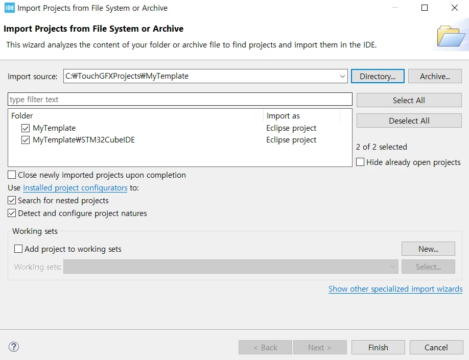

  1. In TouchGFX, Make project and generate code. ( ex. Project name is MyTemplate. )
  2. In STM32CubeIDE, File -> Open Proejct File system.
  3. In STM32CubeIDE, Import Project from File System or Archive -> Directory -> Find MyTemplate proejct and Finish0693W00000JMmeiQAD.png

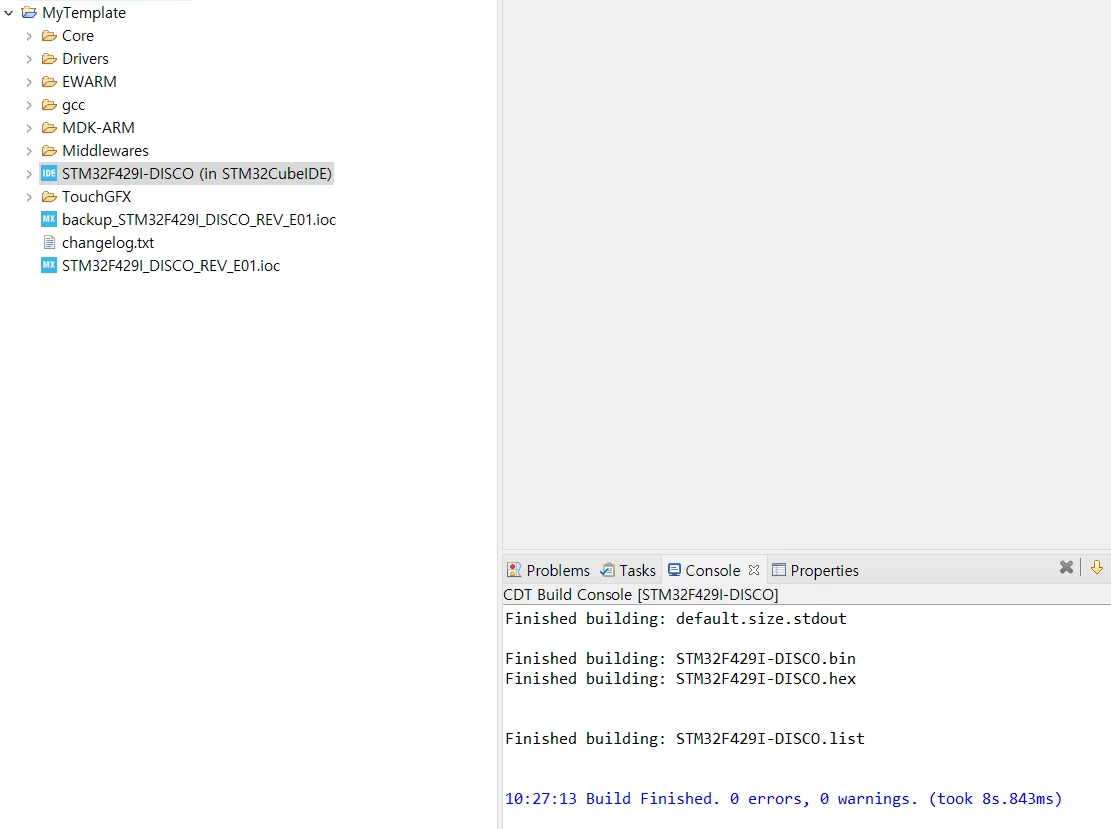

  4. In STM32CubeIDE, Click STM32F249I-DISCO( in STM32CubeIDE ) and success build0693W00000JMmexQAD.png
  5. In STM32CubeIDE, Click STM32F429I_DISCO_REV_E01.ioc and rename MyTemplate.ioc.0693W00000JMmfRQAT.png

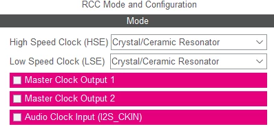

  6. In STM32CubeIDE, Open MyTemplate.ioc file and RCC setting. ( HSE -> Crystal/Ceramic Resonator, LSE -> Crystal/Ceramic Resonator )0693W00000JMmfqQAD.png
  7. In STM32CubeIDE, RTC check Active Clock Source.

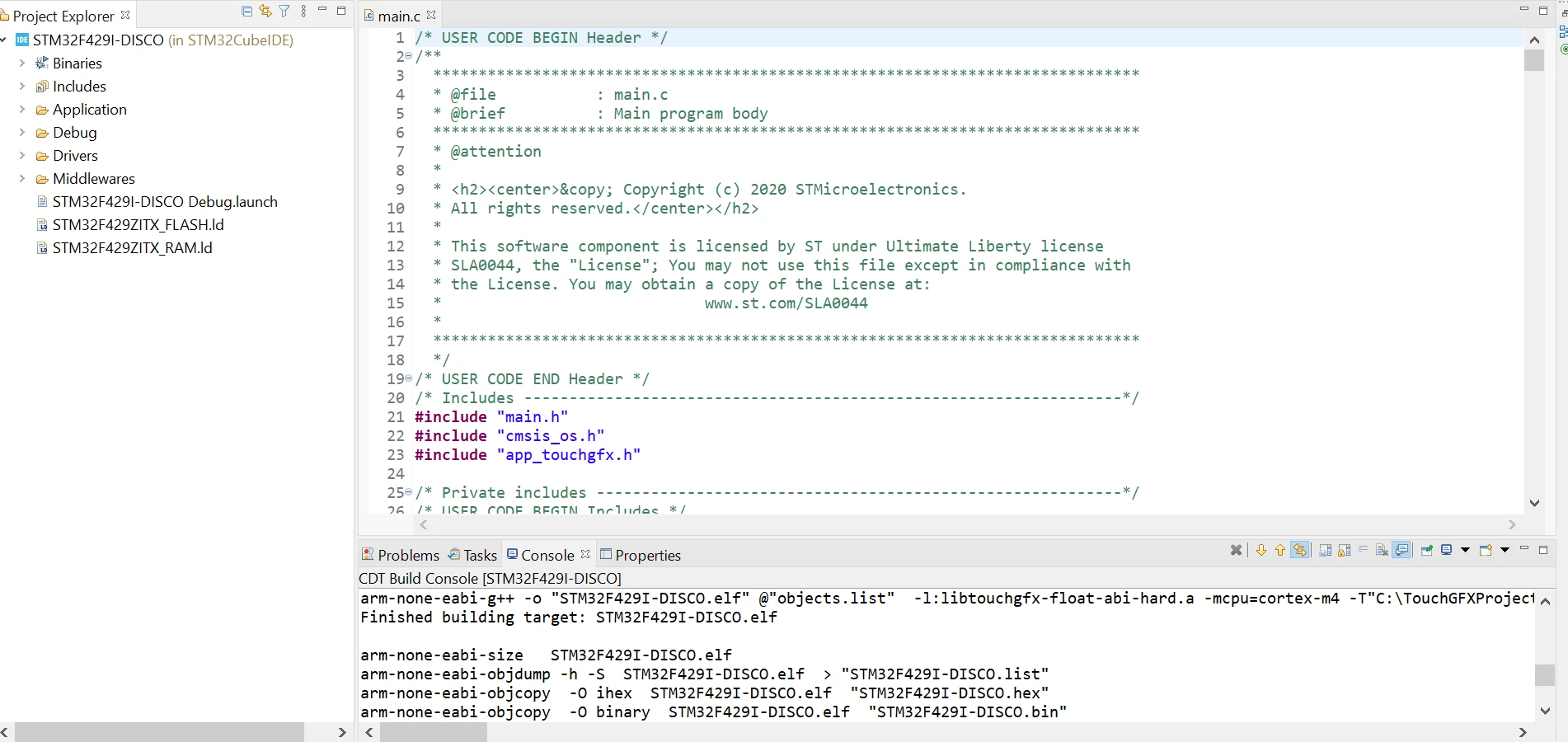

  8. In STM32CubeIDE, Save the MyTemplate.ioc file and Click STM32F249I-DISCO( in STM32CubeIDE ) icon build project.
I ran a few test( DAC, ADC, UART ..), but all failed with similar problem.
( Undefined reference to 'HAL_DAC_init' ...)
Can you help me, how to import from TouchGFX to STM32CubeIDE?

  4. Go to C:\TouchGFXProjects\MyTemplate\ open the file STM32F429I_DISCO_REV_E01.ioc with STM32CubeMX. I am using the version 6.3.0.
  5. In STM32CubeMX, Open MyTemplate.ioc file and RCC setting. ( HSE -> Crystal/Ceramic Resonator, LSE -> Crystal/Ceramic Resonator )
  6. In STM32CubeMX, RTC check Active Clock Source.

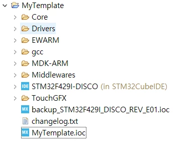

nbila.1
October 25, 2024
I understand what's problem.
If you take look at the hierarchy under driver/stm32f4xx_HAL_Driver.
You will notice hal file related to rtc not present. You have to link this file path so that this file will be available.
And after that compile code.
